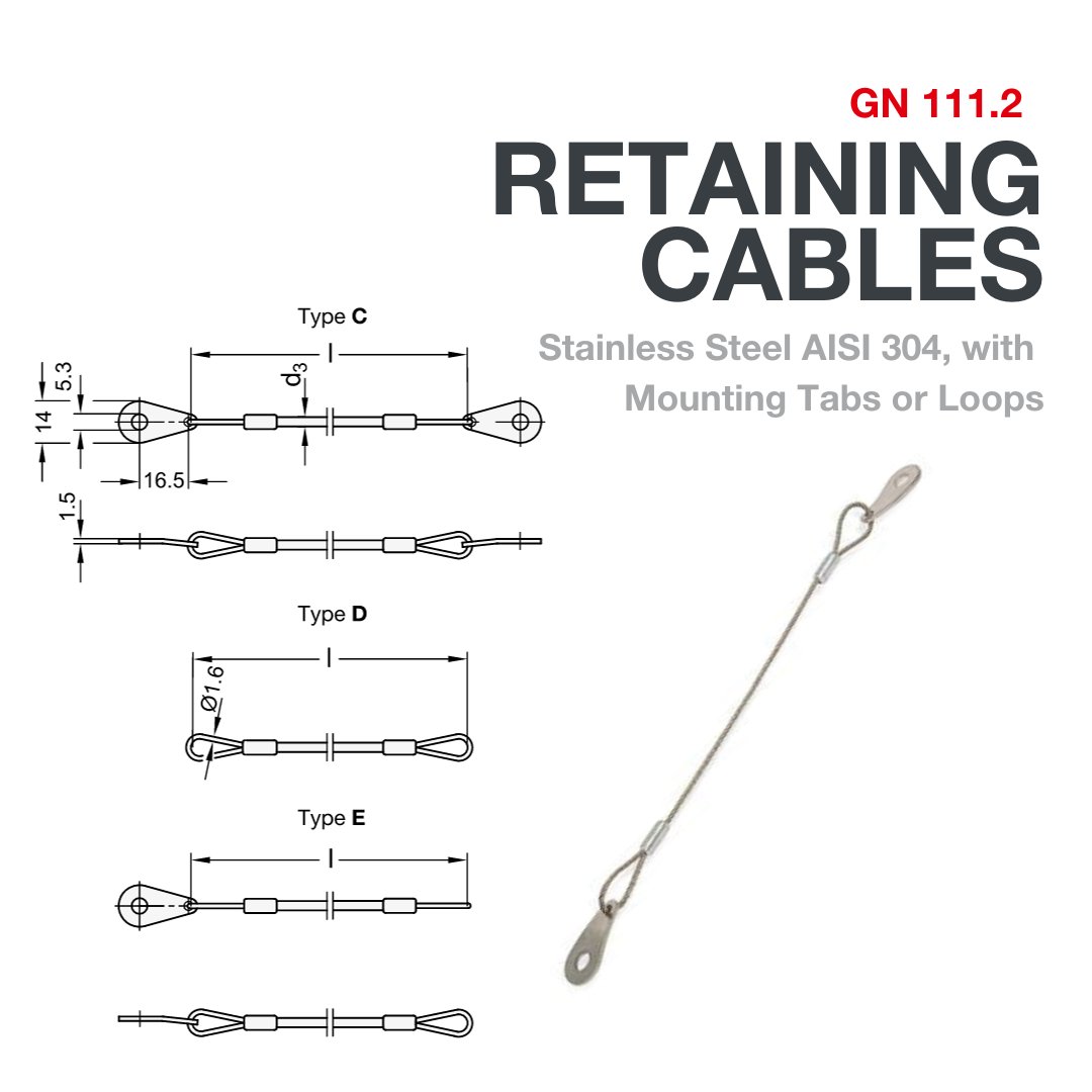

Standard parts specialist JW Winco offers five types of retaining cables for various applications. Retaining cables are designed to retain or secure components, and are ideal for loss protection, cable connections, and fastening.
The GN 111.2 Retaining Cables are available in Stainless Steel AISI 304, with one or two key rings and one mounting tab. The key rings are supplied as mounted on the retaining cable.
They’re available in a plain finish or coated with plastic (PVC). The versions with coating (TR and SW) protect adjacent parts from chafing or other damage. The surface is smooth, however, and gentle to the touch.
The GN 111.2 is available in a translucent or black finish. The black design is visually discreet and is used when reflections on the surface are to be reduced.
Available features:
Mounting tab
Stainless steel AISI 304
• Plain finish (for BL / TR)
• Zinc-plated, black passivated finish (for SW)
Key ring
Stainless steel AISI 301
• Plain, tumbled finish (for BL / TR)
Press sleeves
Aluminum
• Black anodized finish (for SW)
