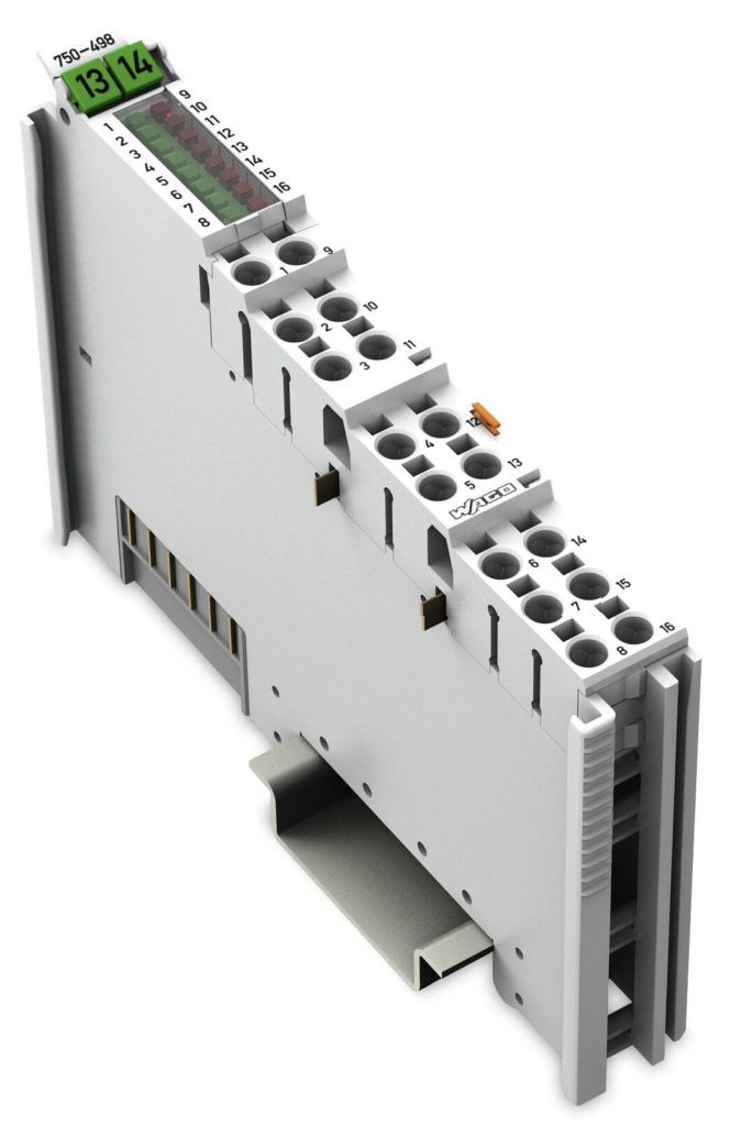

WAGO launches thermocouple analog input module
By PR Editor | December 1, 2020
WAGO’s 750 series (750-498) 8-channel thermocouple analog input module is compact, easy to wire, configurable, and is 12 mm wide, saving space in control cabinets and reducing installation and commissioning time.
The 750-498 can be configured by channel for thermocouple types B, C, E, J, K, N, R, T, and S using WAGO-I/O-CHECK software or e!COCKPIT configuration tools. It can also be used to measure millivolt ranges -30…+30, -60…+60, -120…+120, and -240…+240. Users can select between internal and external cold junction temperature compensation.
The 750-498 module has gained approvals from cULus for standard and Hazardous Locations plus marine DNV certification.
