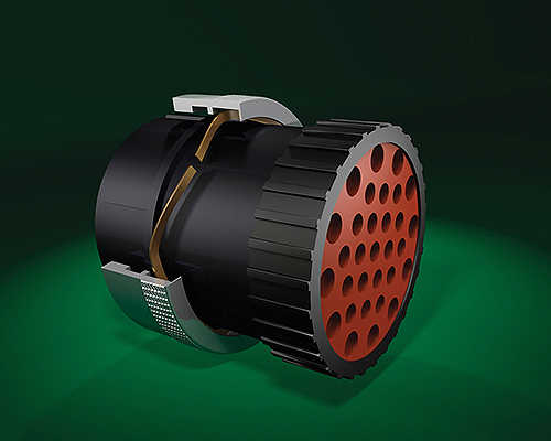

Flatwire wave springs and retaining rings are used in a variety of quick connectors and circular plug-in connectors with threaded and bayonet locks. They are used for military, aerospace, and industrial applications. You have the choice of single, nested, and multi-turn wave springs.
A single-turn wave spring with overlapping ends saves axial space so that more space is given for travel (30% more travel compared to a standard coil spring). The spring clings to the bore, which saves more radial space compared to a stamped wave washer. The overlapping ends prevent radial jamming because a circumferential movement is allowed. The spring ends could move against each other so that the specification ‘load at work height’ is always given.
Flatware-wave-springs-and-retaining-rings
Flatware wave springs and retaining rings are used in quick connectors and circular plug-in connectors with threaded and bayonet locks. They are used for military, aerospace, and industrial applications.
The spring is coiled so there are no stamping burrs to cause scratching of the housing or shaft. The overlapping ends also have edges with a radius, which also prevent scratching. After connecting the male and female component of the quick connector, the wave spring provides a constant force at its work height with a low load tolerance of ±10% max. This is important to guarantee enough force for a continuous, safe connection. Stainless steel and exotic materials can be used to provide the correct amount of corrosion resistance as required (e.g. AISI 316 stainless steel for offshore connectors).
