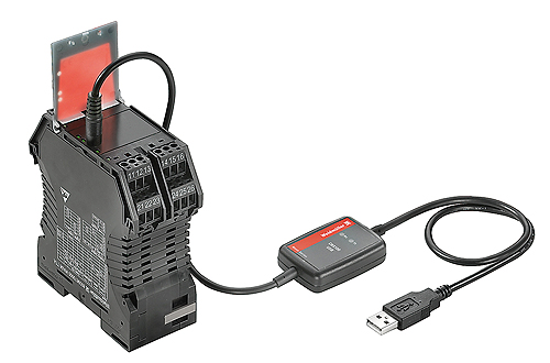

RICHMOND, VA – Weidmuller introduces of a new class of signal conditioner — the Wave TTA. This new module provides a unique degree of flexibility, functioning as a signal isolator, transmitter, converter, linearizer and trip amplifier, all in a single unit. It offers users precision measurement accuracy to meet the diverse and demanding needs of the process industry. The Wave TTA continues Weidmuller’s strategy of providing premium, high-quality electronic solutions to complement their trusted connectivity solutions.
Weidmuller’s new Wave TTA
In one module, all common analog DC input types (including temperature, DC and frequency) and ranges can be accepted. All output types such as bipolar are settable. Input/output configuration changes are simple to perform via laptop or PC with the easy-to-use, free, downloadable software.
Process industry users will benefit from a wide range of features, such as the ability to mount the Wave TTA signal conditioner in any location, and with virtually any power supply. The -40ºF to 158ºF operating temperature range allows for mounting the module in either the factory or a field enclosure, and the universal AC/DC power input makes installation easy and cost-efficient. The IP20-rated Wave TTA also features a compact, space-saving design at only 45mm wide. Approvals include cULus for use in the U.S. and Canada.
