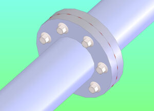

Pipe flanges
Pipe flanges form a rim that radially protrudes from the end of a pipe. They have several holes that allow two pipe flanges to be bolted together, forming a connection between two pipes. A gasket may be fitted between two flanges to improve the seal.
Pipe flanges are available as discrete parts for use in joining pipes. The pipe flange is attached permanently or semi-permanently to the end of a pipe. It then facilitates easy assembly and disassembly of the pipe to another pipe flange.
Pipe flanges are classified according to how they are attached to the pipe.
A pipe flange.
