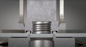

Pierce-clinch nuts are self-piercing and require no hole to be pre-punched into a sheet or the workpiece. The nut is simply pressed in from one side, with a die on the opposite side. A central disc is sheared away, leaving a hole in the sheet where the pierce-clinch nut is pressed.
Once this installation is complete, the sides of the hole in the sheet deform into indentations in the perimeter of the nut — locking it into place in a clinching process. This is all carried out in a single operation that takes less than a second.
