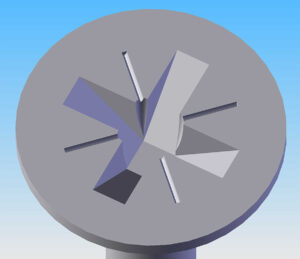

Pozidriv screws are externally threaded fasteners with torquing heads, which feature a cruciform socket with radial indentations that are set at 45 degrees from the main cross.

The Pozidriv features parallel flanks and additional ribs at 45 degrees to the main cross, which provides greater mating with the driver, reducing cam-out and improving efficiency. This allows for greater torque while reducing screw damage, driver wear, and worker fatigue. It also increases installation speeds.

Less popular than the Pozidriv fasteners, Supradriv screws can be distinguished by two radial indentations. The Pozidriv heads have four.
