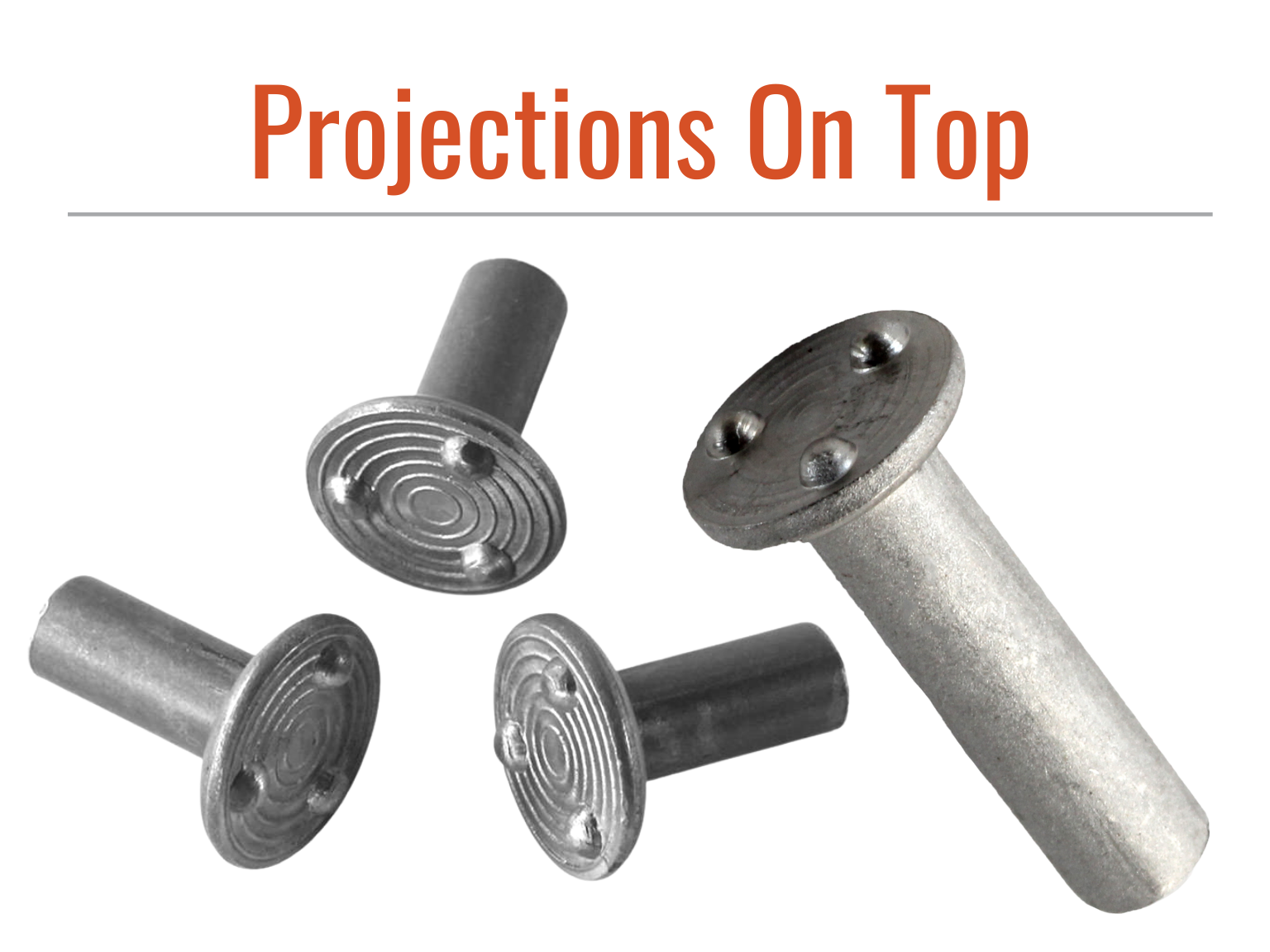

On top of the head
This type of projection weld pin is designed with three precise weld projections on the head, which attaches to the underside of the opposing panel — without the need for a through-hole.
These weld fasteners are used when a smooth outside surface is necessary for the pin to fasten into place. The cold-forged construction of the weld pin provides a strong connection on the bearing surface and acts as a stop, hinge, or mounting pin.
Weld pins with the three projections on top need no mounting hole, thereby providing durability and a smooth appearance. As these pins are welded permanently to the component surface, they’re ideal for permanent welds in concealed locations and blind applications.

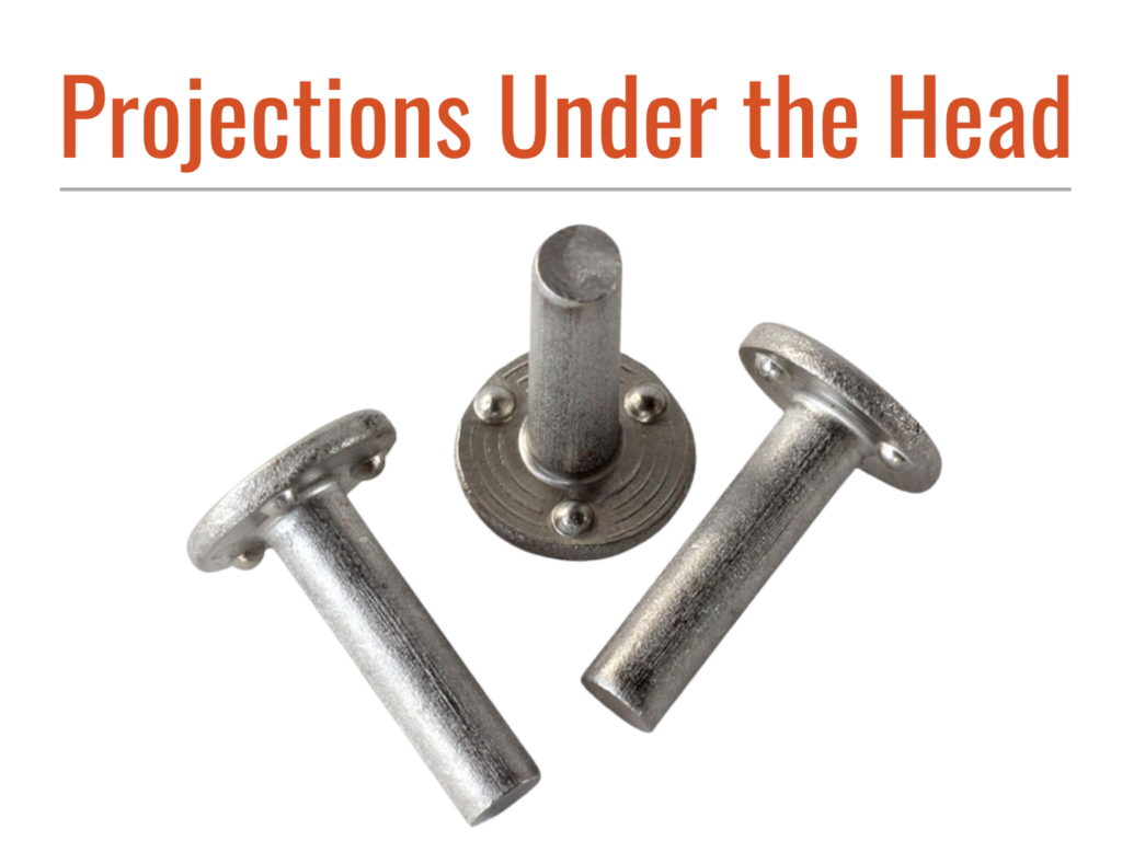

Under the head
Welding pins with the three projections on the underside of the pin head are used in through-hole applications. The three precision projections permit exact positioning and balance for an optimum weld.
“On top of the head” projection weld pins, which are ideal for permanent welds in blind applications.
In through-hole applications, the head of the pin is welded to the metal component, making the joint stronger than the surrounding area. The strength of this connection makes this type of weld pin ideal for hinge pins, bearing surfaces, structural supports, and stops.
