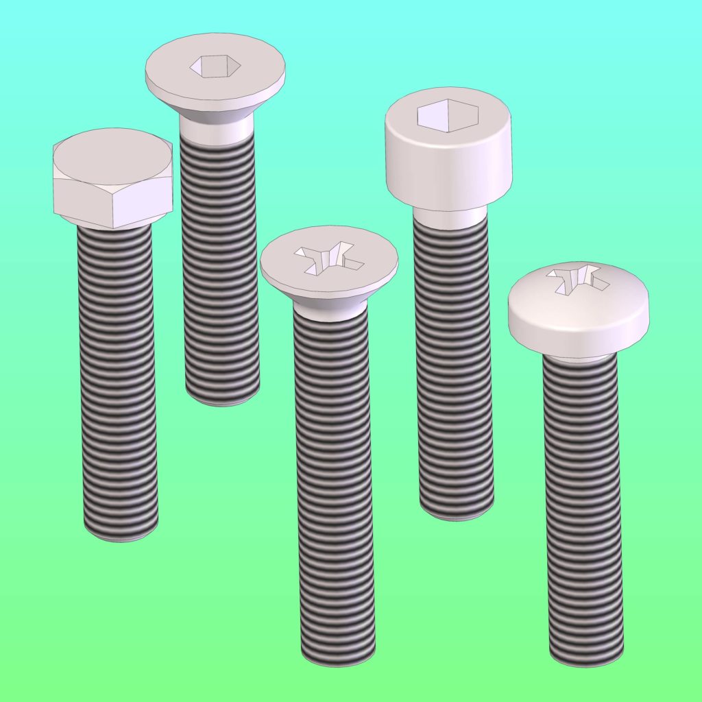

Machine screws
A selection of machine screws, from left to right: Hex screw, hex socket countersunk head screw, countersunk head cross screw, hex socket cap screw, and pan head cross screw.
Machine screws have a standard thread on a parallel shaft, designed to be screwed into a tapped hole in a part, they may also be used with a nut. The most common type of machine screw is a hex screw — which is very similar to a hex bolt, but without the shank. There are many types of machine screws for specific applications, generally differing in the shape of the head:
  • Countersunk head screw: A tapered head designed to be countersunk so that it lies flat with the surface of a part, with a.
  • Cap head screw: A barrel shaped head with a socket, designed to fit into a counterbored hole.
  • Pan head screw: A domed head fitted with a socket
  • Grub screw: A type of set screw which is has its entire outer surface threaded, with no head, allowing it to be screwed all the way through a hole to lock against a part below the hole.
Socket headed screws may have many different socket types. The order in which the shape of the head and the socket are given in the name may vary. Some of the most common socket types are:
  • Hex socket or ‘Allen key’
  • Cross head
  • Torz
  • Pozidriv
Machine screws are graded according to their strength, using the same system as bolts, with two numbers separated by a point. The first number is the ultimate tensile strength (UTS) in MPa divided by 100 and the second number is the ratio of yield strength to the UTS. Common classes are 5.8, 8.8, and 10.9. For example, a grade 8.8 screw has a UTS of 800 MPa and will yield at 80% of this value (640 MPa).
