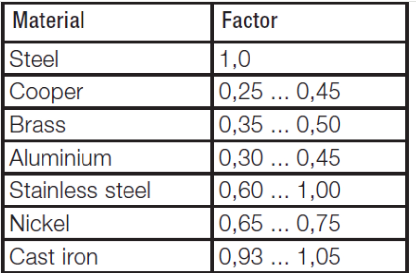

Some industrial processes require detecting the proximity of a variety of materials. That can be accomplished using an inductive proximity sensor and applying the required correction factor, essentially recalibrating the sensor system based on the material properties. For example, if a sensor is rated for a 4 mm operating distance for detecting steel, and the new target is aluminum, a correction factor of 0.30 to 0.45 can be calculated (calibrated) to the operating distance of 1.2 to 1.8 mm (Table 1).
Table 1. Compensation factors for inductive proximity sensing. (Table: Balluff Automation)
