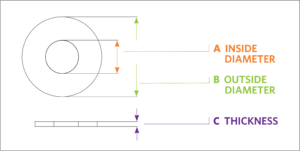

The top and side views of a hardened and unhardened flat washer.

Hardened vs. unhardened flat washers

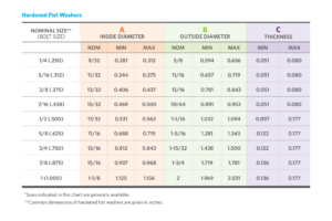

Hardened flat washers are designed for assembly with a Grade 5 or higher strength bolt between the bearing surface of the fastener and the part to which it’s attached. These washers are carbon steel and can be through-hardened to Rc 38-45 or carburized (case hardened) to a minimum depth of .015“. They have a surface hardness of 37-45 Rc with a minimum core hardness of Rc 30.

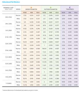

Unhardened flat washers are designed for assembly with Grade 2 or lower strength bolts or tapping screws between the bearing surface of the fastener and the part to which it’s attached. Narrow (SAE) and wide (USS) flat washers are available for specification, depending on the required outside diameter.
The specifications of hardened flat washers.

The specifications of unhardened flat washers.
