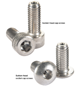

Socket-head cap screws are machine screws with a cylindrical barrel-shaped head containing a hexagonal socket that fits a wrench for turning (instead of a slot or external hexagonal). These properties mean that socket-head cap screws are ideal for use in confined spaces. Socket cap heads are small, so the size of the component parts can be reduced, saving material costs. Smaller parts cost less to drill and tap, take less energy to drive, and weigh less than alternatives.
Button-head socket cap screws have a rounded, low-profile head containing a hexagonal socket that fits a wrench. These screws offer a flush profile, making them ideal for use in areas with little overhead or clearance and in confined spaces. They work best in light-duty applications such as in removable panels. Their wider bearing surface and high-tensile strength mean they’re also reliable in security applications.

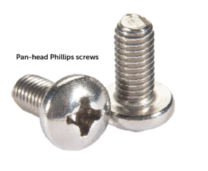

Pan-head Phillips screws take their name from the appearance of their head, which looks like an upside-down frying pan. This is a common head type of the non-countersunk used in machine screws. They have wide heads, a flat bearing surface, high vertical, chamfered, or curved sides, and a flat or slightly domed top.
A pan-head Phillips head has two partial slots crossed at right angles, driven by a special screwdriver called a Phillips screwdriver. As mentioned, this system is self-centering.
