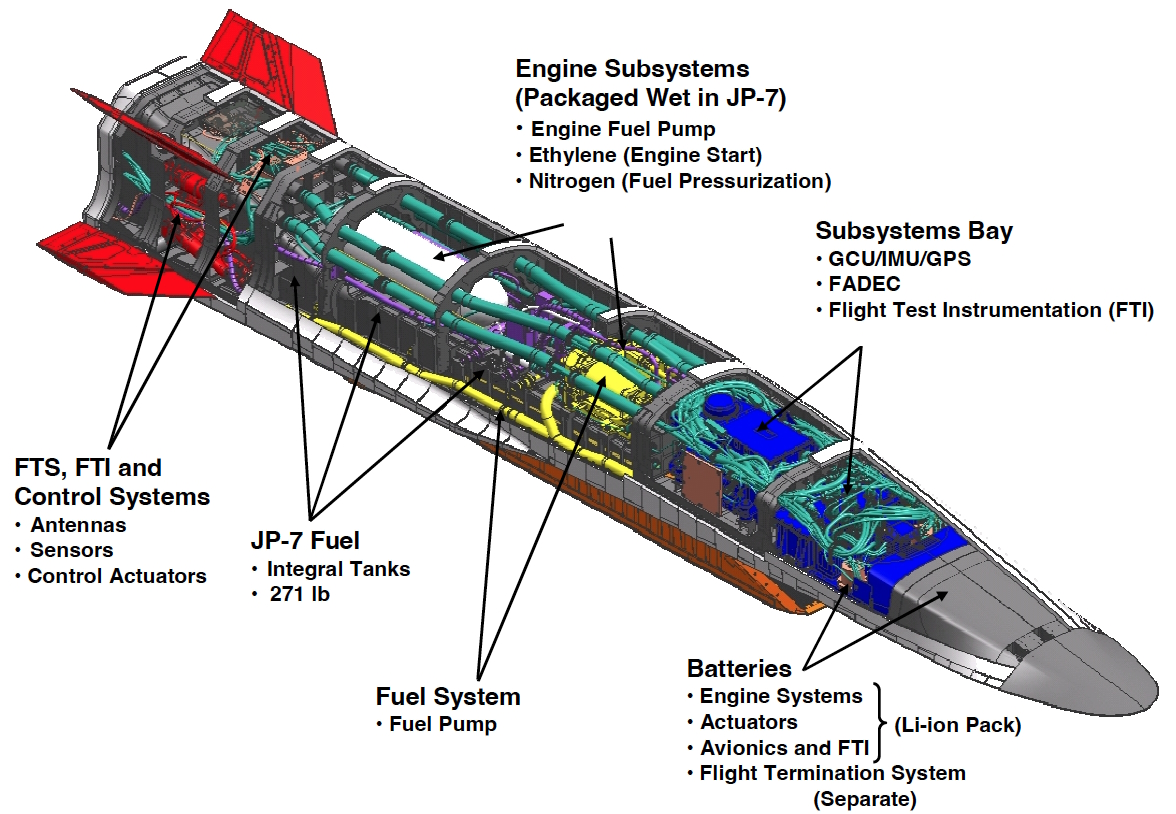

A hypersonic missile travels at Mach 5 or faster (about 3,800 mph), but many ballistic missiles travel at even higher speeds. What sets hypersonic missiles apart is their ability to navigate and maneuver. This requires avionics, including sensors, actuators, a flight computer, etc. Connectors must also stitch the various subsystems together into a coherent package (Figure 1).
Figure 1. Cutaway view of a prototype hypersonic missile. (Image: Stockholm International Peace Research Institute)
The skin temperature of a hypersonic missile can exceed 1000 °C, and even with good thermal management, the interior thermal environment is challenging. Electronics, including connectors, are also subjected to extreme thermal shock. The temperature can change rapidly at the launch and during maneuvers, adding to the thermal challenges.
Forces experienced during maneuvers can exceed 50 Gs. That can disrupt or destroy standard connector designs. So, the connectors need to be exceptionally rugged — the space constraints inside a hypersonic missile demand lightweight and miniaturized connector solutions.
Those miniaturized connectors must maintain signal integrity and quality to support high-speed interconnects. Designing compact connectors that can survive the harsh environment and minimize signal loss and interference can be daunting. It can require that connector designers turn to new materials.
