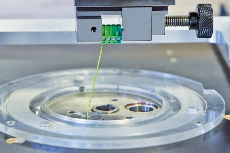

The flexion test, or rotation test, is detailed in IEC 60999‑1. A conductor is attached to a vertically fixed connector, and a test weight determined by the connector cross-section is attached to the opposite end of the conductor. The conductor is fed through a 37.5 mm circular hole in a rotating disc that is spun on its horizontal axis 135 times (Figure 2). Following the test, the contact must pass the IEC 60998-2-1 pullout test.
