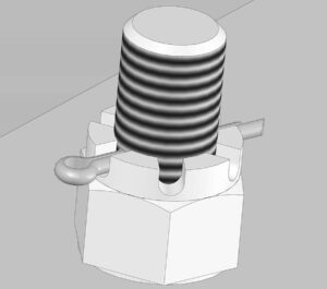

A castellated nut has notches that allow it to be pinned to prevent rotation.
A castellated nut, also known as a castle nut, has three notches in one end, giving an appearance similar to the crenellated battlements of a castle. Castellated nuts are a positive locking device that’s used to ensure that the nut remains affixed and resists vibration.
These components are used in combination with a screw that has a pre-drilled radial hole. The nut is attached and a pin is passed through the notches and the hole in the screw, preventing the nut from turning.
Several types of pins may also be used for this purpose. These include:
  • A cotter pin, also known as a split pin — a fastener with twin tines, which after insertion are bent apart to prevent removal.
  • An R-clip, also known as a hairpin cotter pin or hitch pin — a sprung metal fastener with one straight leg inserted into the hole and one profiled leg that grips the outside of the nut.
  • Safety or locking-wire — a wire that’s passed through the notches and the hole, then twisted, and anchored to secure the nut.
With six notches spaced at 60-degree intervals, the castellated nut can only be locked where a notch corresponds to the hole. After correct torquing, it’s necessary to turn the nut again up to 30 degrees (in either direction) to locate the hole.
