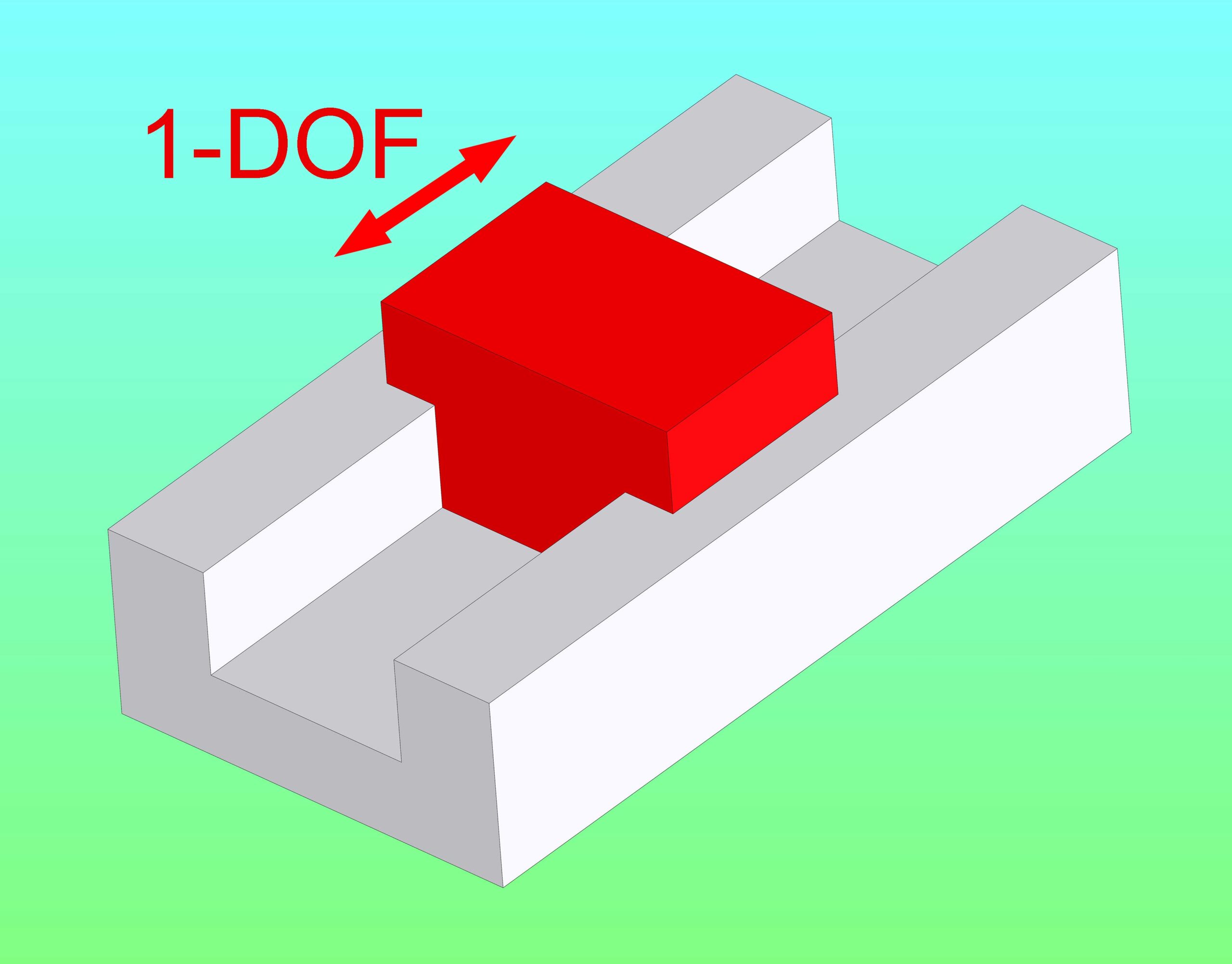

A prismatic joint is a connection between two objects that allows relative motion along a single axis. Motion that’s perpendicular to this axis (or rotation about any axis) is prevented. This means the joint has one degree of freedom (1-DOF).
A prismatic joint allows only linear motion along a single axis.
A prismatic joint is often called a slider — as for example a “crank-slider linkage.” This is a type of kinematic pair and an idealized way to describe how motions are constrained within machines.
There are several physical embodiments of a prismatic joint, such as slideways. Rectangular cross-sections may be used in combination with plain or rolling bearings to enable linear motion while preventing rotation about the axis of movement.
