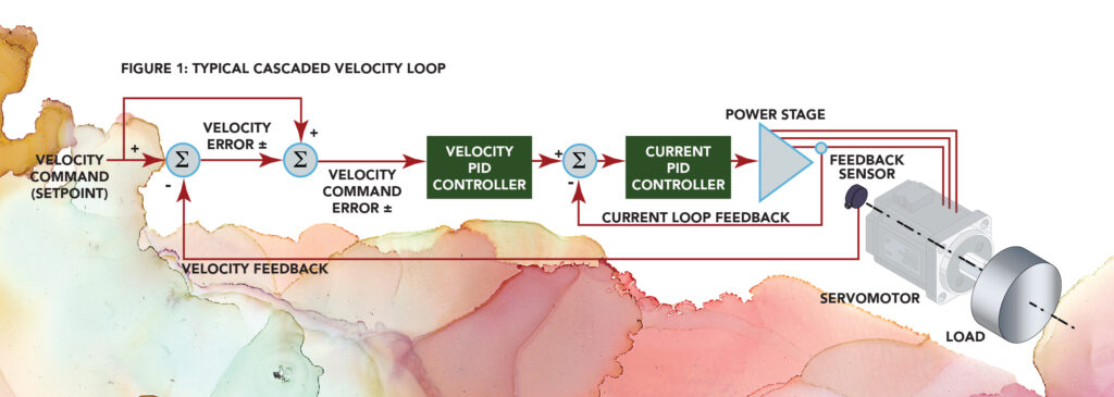

In a real-world motion system application such as positioning a linear actuator, the velocity command received by the controller’s position-loop is constantly changing through accelerations, stroke reversals, decelerations, load disturbances, and so on. Getting the best possible performance relies on optimal control of the axis’ dynamic response to these conditions via PID control within each control-loop of the circuit/algorithm.
Shown here is a typical cascaded velocity loop.

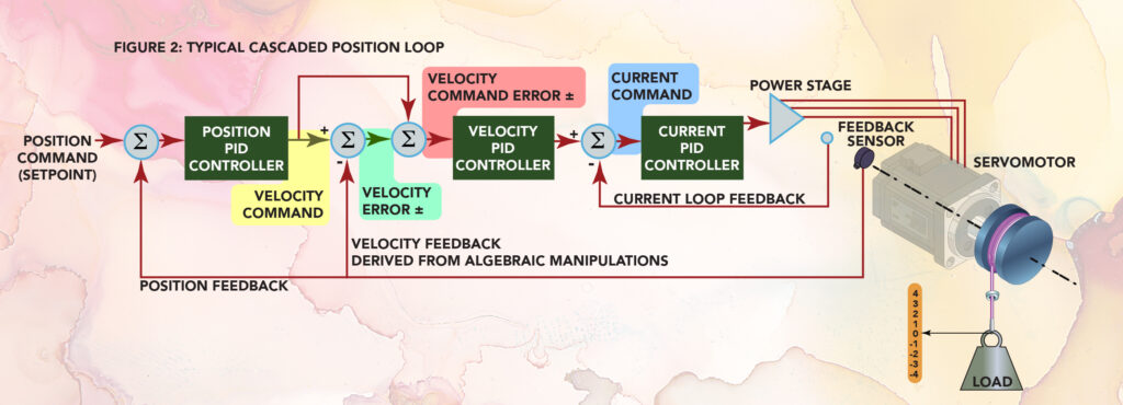

Shown here is a typical cascaded position loop.

3. A typical servomotor application will operate in one of three operational modes depending on the application and selected control method. These include current/torque mode (with current-loop closure); velocity mode (with vel-loop closure); or position mode (with pos-loop closure).
Current-loop PID closure can be operated on its own because it’s the innermost and fastest control loop. In contrast, the velocity-loop PID closure includes an inner current loop … and position-loop PID closure includes both an inner velocity and current, loop.
