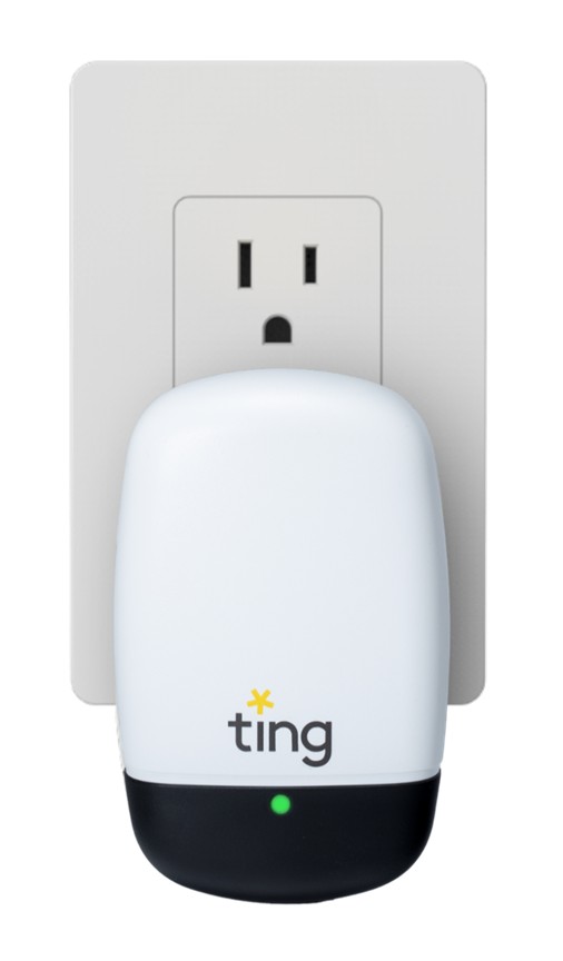

Figure 1. Smart plug-in sensor detects arcing that causes fires (Image: Whisker Labs).
Ting sensor
One not-so-obvious sensor for fire warnings identified early in the investigation was Whisker Labs’ Ting sensor. The patented sensor detects faults generated by electrical arcs. Plugged into any home’s standard single-phase, 120-V outlet, the Ting sensor uses a Wi-Fi connection to communicate with the Ting servers. The sensor detects the low-level electromagnetic emissions associated with micro-arcing characteristics of potential electrical faults that generate very high frequencies. At these frequencies, home wiring provides a communications network for the signal. Using post-processing algorithms, the Ting sensing system separates the signal from the noise and detects if there is unusual electrical activity.
Since dangerous arcing is the precursor to most electrical fires, State Farm Insurance has collaborated with Whisker Labs to provide free Ting sensors nationwide for eligible customers. With a network of around 14,000 sensors located in homes across Los Angeles, Whisker Labs was able to monitor the electric utility grid. Specifically in the Palisades area, 63 faults were identified two to three hours before the fire ignition. Also, 18 faults registered within the hour the fire began.
