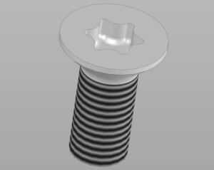

A Torx screw is a six-lobed, star-drive socket or external head.
A Torx screw is a type of screw characterized by a six-lobed, star-patterned screw drive. Torx drive is a trademark commonly referred to as star drive or, simply, a six-lobe. It’s often abbreviated to TX or 6lobe. The ISO name is hexalobular.
Torx is available as an internal and external drive although it is most commonly used as a socket within the head (internal).
Torx screws were invented in 1967, by Camcar Textron, as an improvement on contemporary drive types. It aimed to replace Phillips, which was prone to cam-out, and the internal hex drive, which tended to fail during high torque by rounding off.
Torx does not cam-out and can withstand higher torques than internal hex at a given head size. Vertical sidewalls maximize tool engagement and produce no cam-out forces to push the driver out of the screw head, resulting in less fatigue as no end load is required. It’s also less likely to damage the driver or driven screw.
With a perpendicular drive angle to the axis of the fastener, Torx drive produces minimal radial force. This force distribution allows a higher torque to be transmitted with little likelihood of reaming of failure — either of the driver or the driven screw.
