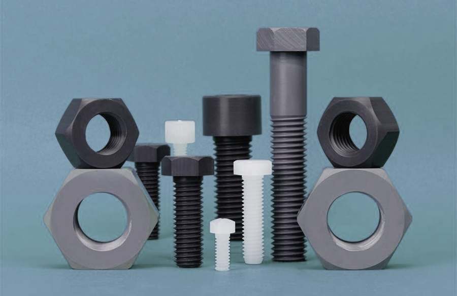

PTFE or Teflon-coated fasteners are highly corrosion resistant, especially at elevated temperatures.
PTFE is more commonly referred to as Teflon, a registered trademark of DuPont, the multinational chemical company where the material was first developed. PTFE is often fabricated into fasteners, such as screws, hex nuts, hex-head cap screws, flat washers, and others. It’s also used to fabricate custom parts. However, this material can only be turned, or made into parts on a CNC machine.
Although PTFE can be compression molded (using high pressure and heat), it cannot be injection-molded (which injects the raw material into a mold cavity). This is because it’s not thermoplastic. Thermoplastics are pliable at elevated temperatures and then solidify upon cooling.
So, what is Teflon exactly? Polytetrafluoroethylene (PTFE) is a solid fluorocarbon and synthetic fluoropolymer. The material is made wholly of carbon and fluorine atoms. It has a high molecular weight and is hydrophobic, meaning it does not absorb water.
Fasteners and custom parts made of PTFE are used in applications where high heat and chemical resistance are required. One disadvantage is that PTFE is that it’s not very strong. For instance, it’s so soft you can make an imprint in the material with a fingernail. PTFE is a deformable plastic and is not elastomeric, so it does not naturally retain shape and is subject to creep.
