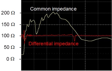

The plot below shows an example of the measured differential and common impedance profile for a twisted pair, taken out of a Cat5 cable and spread over a table top.
The typical common impedance of an unshielded twisted pair will vary from around 100 Ω to 200 Ω. As long as there are no common signals on the twisted pair, you don’t need to care about the common impedance. The challenge is preventing common signals from getting on the twisted pair.
