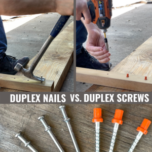

Duplex Nails and Screws are flanged-head or double-headed fasteners that are often used to build temporary structures such as braces, scaffolding, and concrete formwork. They’re designed to be removed with ease, so they do not completely go into the wood during installation.
First came the nail

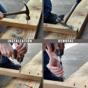

Duplex Nails are as strong as regular nails, but the double head makes them easier to remove with a claw hammer or crowbar. Workers drive the nail until the lower flange is flush with the material. With a pull bar or the reverse end of a claw hammer, the nails pull out after the job is complete.

Duplex Screws feature a double-hex head, which accepts a variety of driving tools — including a pile driver or hex-head screwdriver — for installation and removal after use. The driver drills the orange hex-head screw until the stop flange is flush with the material and can easily remove it by reversing the drill.
Since there’s no need to force the removal, the screw maintains its shape and can be reused multiple times.

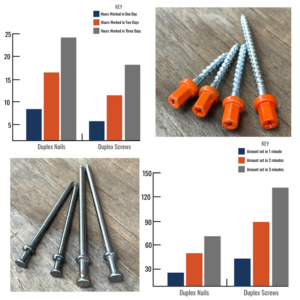

Timed tests
In timed comparison studies, Duplex Screws outperformed Duplex Nails by a wide margin. During three workdays, a pair of concrete-form setters built a 50 x 50 lineal-foot form. One worker used only Duplex Nails and the other worker used Duplex Screws.
The Duplex Screw user outperformed the Duplex Nail driver in setting and form stripping, completing the task in six compared to eight hours.
In another study, crews were timed for one minute to see how many screws and nails could be installed in the same amount of time. The results showed a 47% difference, with 45 Duplex Screws drilled in versus 24 Duplex Nails hammered in.
Duplex Screws outperformed Duplex Nails in timed comparison studies.
