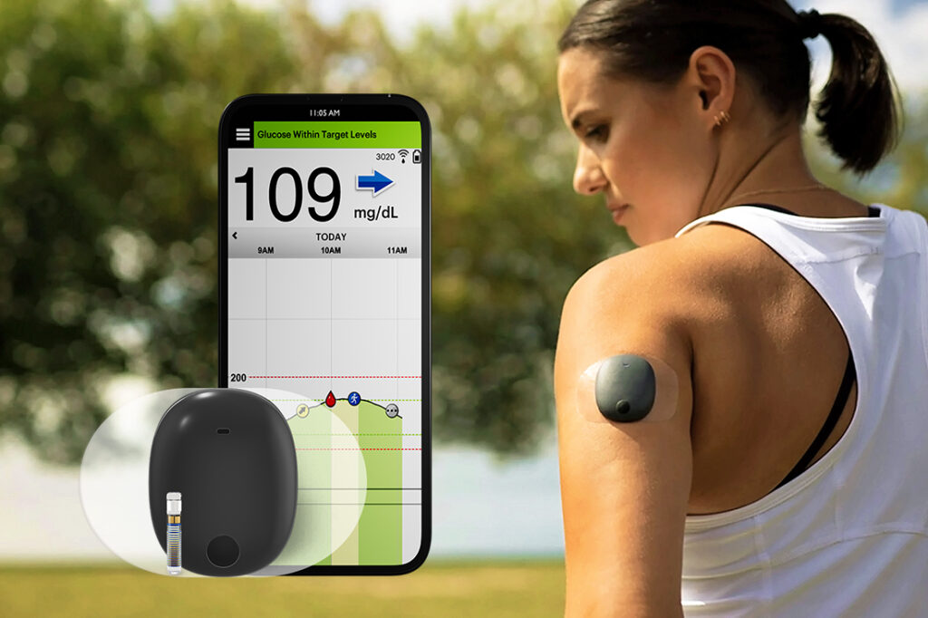

As shown in Figure 3, CGMs must operate reliably in dynamic environments, where body motion, sweat, skin oils, and temperature fluctuations can disrupt signal transmission.
Figure 3. Eversense 365, an implantable CGM, transmits glucose readings to a smartphone every five minutes. (Image: Eversense)
Long-term reliability depends on careful material selection, with conductive, corrosion-resistant materials required to maintain electrical performance over time. Biocompatibility is also a critical design factor for implanted components or those in direct contact with skin. Interconnects must resist degradation and prevent adverse biological reactions, adding complexity to both design and regulatory compliance.
Mitigating electromagnetic interference (EMI) from nearby devices presents additional design challenges. Shielded, high-performance interconnects and advanced connectors maintain signal integrity by minimizing electrical noise and EMI, ensuring accurate glucose readings, reliable data analysis, and consistent insulin delivery.
