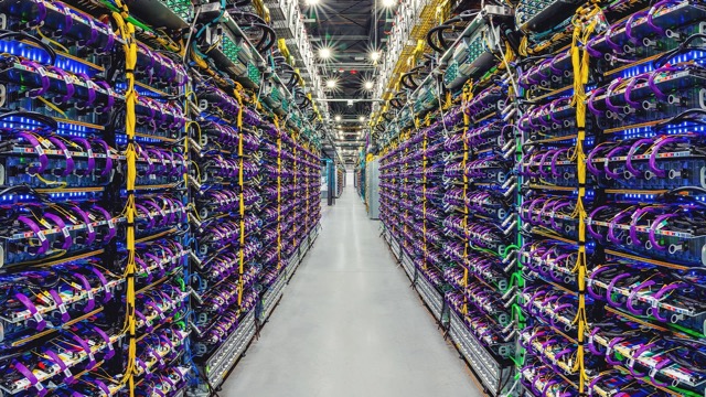

Accounting for 10% to 20% of all energy consumed in US data centers (Figure 1), AI-driven applications are considerably more power-intensive than many conventional workloads. For example, a ChatGPT query draws ten times more energy than a standard Google search. As computational power requirements for AI model training double every nine months, data centers may soon consume as much energy as entire countries.
Figure 1. An inside look at a data center showcasing extensive server infrastructure. (Image: DataCenterKnowledge)
With thermal design power (TDP) requirements reaching 1500W and average rack power increasing from 8.5 kW to 12 kW, effective cooling systems are critical to maintaining optimal data center temperatures of 70 to 75°F (21 to 24°C). Cooling infrastructure now accounts for approximately 40% of total energy consumption in some of theties, prompting organizations such as The Green Grid to develop a Liquid Cooling Total Cost of Ownership Calculation Tool (tggTCO).

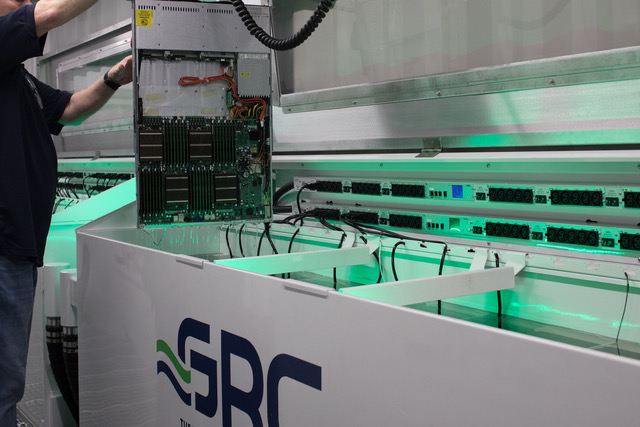

Figure 2. Data center immersion-cooling system with rack-mounted service rails for easy maintenance and hot swaps. (Image: GreenRevolutionCooling)
Data centers typically implement liquid cooling using two primary methods: cold plate and immersion cooling (Figure 2). Cold plate cooling circulates dielectric coolant over or near the hottest components, delivering high performance at the chip level yet still relying on supplemental air cooling to dissipate residual heat. As rack densities increase, cold plate liquid cooling scales more efficiently than stand-alone air-cooling systems, which often struggle to dissipate heat from densely packed equipment.
Significantly reducing the use of auxiliary fans, immersion cooling further improves energy efficiency by dissipating, recapturing, and reusing nearly 100% of generated heat. This cooling method, however, often requires new facility designs, structural modifications, and upgraded or new power distribution systems.
Precision liquid cooling, which occupies a middle ground between cold plate and immersion cooling, uses minute amounts of dielectric coolant to target the hottest components and effectively cool the entire system. This hybrid method, which eliminates water use for cooling, can reduce energy consumption by up to 40%.

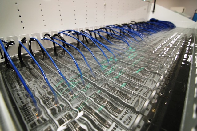

Figure 3. Data center infrastructure submerged in a liquid cooling solution. (Image: AKCP)
Additionally, these connectors ensure easy serviceability and compatibility with water-based or dielectric fluid (Figure 3) mixtures, preventing corrosion and leaks. Liquid cooling connectors also integrate seamlessly with in-rack manifolds and existing cooling infrastructure.
