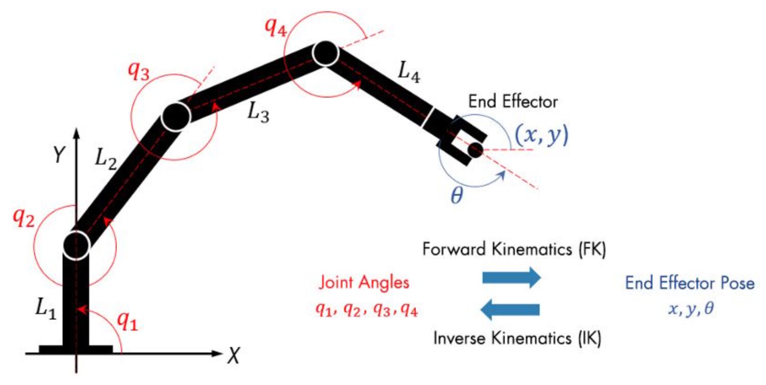

Forward kinematics determines the current position and orientation of the end effector based on the angles of each joint in the robot arm. A series of transformation matrices containing joint angles, length, and offset parameters is used for the calculations.
The transformation matrices are multiplied sequentially from the robot base to the end effector. The result is the position in three-dimensional coordinates and the orientation (in terms of angles) of the end effector. Inverse kinematics reverses the process, determining the required joint angles based on the position of the end effector (Figure 1).
Figure 1. Defining robot joint positions using forward or inverse kinematics. (Image: MathWorks)
