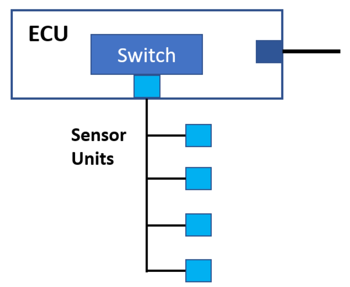

Body-domain functions in zonal architectures, on the other hand, typically need 10 Mbps or less. They are the targets for IEEE 802.cg 10BASE-T1S. It supports multidrop with a reach of up to 25 m. The standard specifies support for at least 8 nodes, but more are possible. It can deliver power over data lines (PoDL) to connect and power sensors, microphones, actuators, and other devices (Figure 1).
Figure 1. 10BASE-T1S can be used to connect electronic control units (ECUs) with sensors and other devices in an automotive zonal architecture. (Image: Teledyne Lecroy)

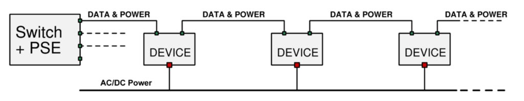

10BASE-T1L (T1L) supports distances up to 1 km using SPE. It does not support multidrop technology but can be implemented using a daisy-chain architecture and can be installed as a ring network for greater resilience and reliability. A newer standard, 10BASE-T1M (T1M), supports multidrop deployments.
T1L and T1M can be used for small devices like sensors or actuators that are solely powered by PoDL or to send control signals for larger devices like motors, solenoids, lighting fixtures, access control systems, and heating ventilation and air conditioning (HVAC) units that require a dedicated AC or DC power source (Figure 2).
Figure 2. 10BASE-T1L can employ a dairy-chain architecture to deliver data and power over SPE. (Image: IEEE)

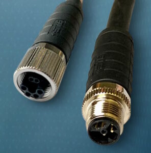

  • IEC 63171-7: M3I3C3E3 hybrid M12 SPE connectors (data and power) (Figure 3).
Figure 3. IEC 63171-7 hybrid SPE connector. (Image: TE Connectivity)
