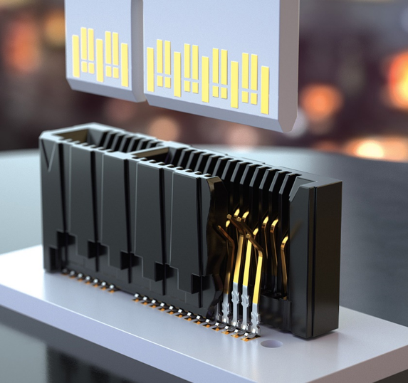

Selective Gold + Tin Plating Option
Selective gold-tin plating is Samtec’s most popular plating option because it provides designers with “the best of both worlds.”  The contact area, the critical area where the contact interfaces the terminal pin and the signal is transferred, has the reliability of gold.  The tail, which is soldered to the board, has the lower cost and solderability of tin.
