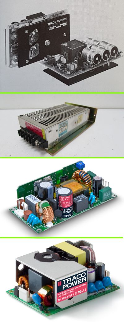

traco combo
Power supplies through the years illustrate how ever more efficient switching power supply technology has made it possible to reduce supply volume. Top, an dc/dc switching power supply on a Eurocard from the year 1977. This supply put out 80 W and occupied a 160×100-mm footprint. It also required a power transformer which is not shown here. Next, an ac/dc switching power supply in a metal package from the year 1990. It put out 100 W and occupied 160×93 mm. Third, an open-frame ac/dc power supply from the year 2005. It put out 100 W and sat in a 101×51-mm space. Finally, an open-frame ac/dc switching power supply from the year 2015. It produces 100 W and occupies 76×51 mm.
