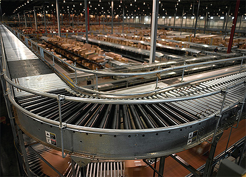

Fig 2: Belt and Conveyor systems
Traditional Curvilinear Solutions
Traditional ways of accommodating curvilinear guide and actuator designs include conveyor systems and slewing rings. A belt conveyor system is the simplest type of conveyor and typically contains wide belts wrapped around cylindrical rollers in a frame. Motors rotate the rollers, which cause the belts to transport payload resting on top of them. While simpler belt conveyor systems can only move payloads in straight lines, curvilinear paths can be created by mounting multiple straight conveyors in series at offset angles along the desired path, or by using belts with interlinked pivoting segments, such as luggage conveyors at airports.
A roller conveyor system is similar to a belt version, except the wide belt is replaced by a series of closely-spaced rollers mounted in a framing system configured to follow a specified curvilinear path. Roller conveyor systems can be powered with motors coupled to the rollers directly or by intermediate drive belts, or un-powered, with payload moved by gravity or by hand.

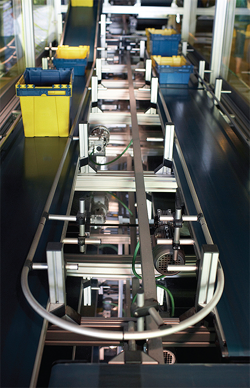

Fig 3: You can easily convert curvilinear guide systems into actuated systems with the addition of components such as drive elements, motors, and carriage linkages.
