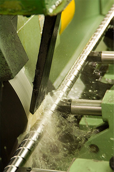

An outside diameter (OD) grinder is shown here grinding the outer diameter of a precision ball screw.

Maintaining consistency in manufacturing also requires strict process controls throughout the machining and grinding processes. This holds true particularly for grinding bearing journals requiring tolerances of a few microns. Because extremely high precision is required to achieve reliable accuracy and long product life, ball screw components should be ground in an environment with strict temperature controls. Even if two interacting components are manufactured to exact specifications, temperature variances can cause them to be out of tolerance when brought together. Ask the manufacturer about their facilities’ climate control.
Strict process control when grinding the ball shaft and ball nut raceways ensures that the contact angles will meet design specifications. Good control of the grinding process should allow for a small range of ball sizes from the nominal. A large ball range from nominal allows the contact angle to shift and can result in decreased life. Most, if not all, manufacturers of high quality ball screws document verification of the preload and torque and compile measurements taken during the heat treat, turning, grinding, lead accuracy, and assembly phases of production. When manufacturing a precision ball screw, systems should be in place to ensure tolerance checks are completed and out-of-tolerance parts are removed from the process. A ball screw supplier should be asked about their process control in manufacturing, the points at which manufacturing inspections occur, and what documentation is maintained and could be supplied upon request.

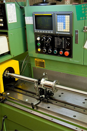

The preload torque measurement insures that the preload is correct. At this point, a number of other tests are done such as flange perpendicularity, concentricity of the nut outside diameter, and the total indicated runout of the shaft. Measurements falling out of a specified tolerance range could lead to premature wear and misalignment of the ball screw.
