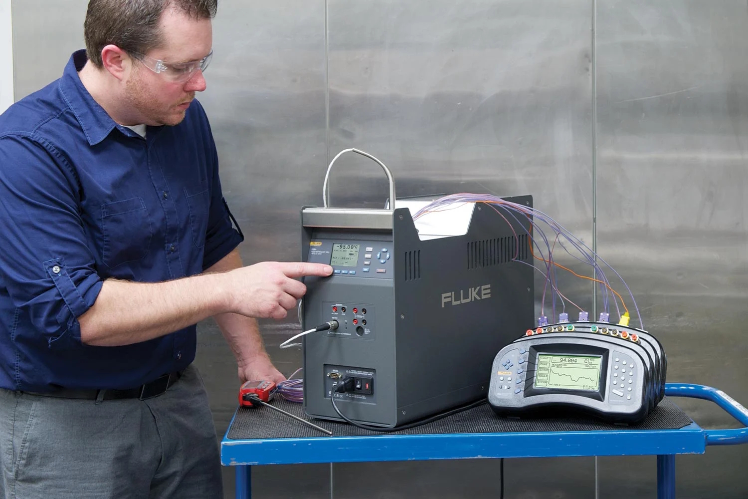

Temperature is the most sensed and measured quantity. It’s crucial for monitoring and controlling temperature in industrial processes, consumer appliances, medical devices, aerospace systems, and more. Accurate calibration of temperature sensors, such as standard platinum resistance thermometers (SPRTs), resistance temperature detectors (RTDs), thermistors, and thermocouples, can be implemented using a dry well and support tools (Figure 1).
Figure 1. Examples of a metrology well calibrator (left) and an expandable and configurable thermometer readout (right) for calibrating SPRTs, RTDs, thermistors, and thermocouples. (Image: Fluke)
Three common techniques for calibrating temperature sensing systems are (in order of improved calibration accuracy):
  1. Using a simulator to calibrate only the electronics.
  2. Using a dry well to calibrate both the electronics and the sensor.
  3. Using a dry well and a reference thermometer to calibrate both the electronics and the sensor.
