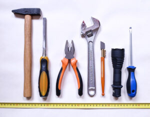

A selection of tools for installing fasteners.
There are several types of fasteners and so, too, are there several available tools for securing industrial fasteners. It’s just as important to choose the correct tool for installation as it to choose the right fastener for an application. The use of an incorrect tool is a safety concern and can lead to an insecure joint or attachment or a broken or faulty fastener.
However, many general-purpose tools are used for fastening, such as drills to create holes or drive fasteners and hammers to drive nails or align parts. There are also several specialized tools for tightening threaded fasteners, inserting rivets, and applying adhesives or welding. So, it’s important to research which tool is ideal for each application.
