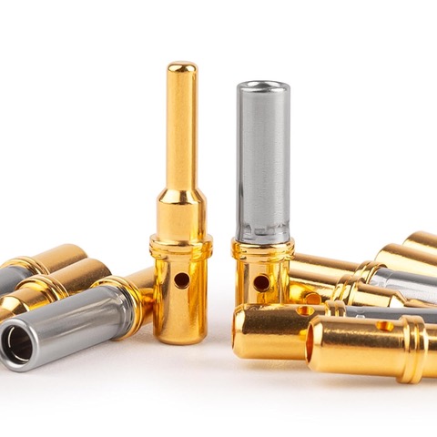

Figure 1. Gold-plated Deutsch connector pins and sockets are designed for high-reliability power transmission in automotive and industrial applications.  (Image: JRready)
Gold remains the preferred connector plating, requiring exceptional conductivity and long-term reliability. As shown in Figure 1, gold plating — typically 10-50 microinches thick — prevents oxidation and maintains low contact resistance over thousands of mating cycles. Its reliability enables consistent performance in harsh conditions across automotive, industrial, aerospace, defense, and medical applications.
To reduce costs, gold plating is often limited to critical contact areas, while tin is commonly used for solderable sections. Notably, advancements in cobalt-hardened gold plating continue to improve wear resistance, accelerating adoption in high-vibration environments.

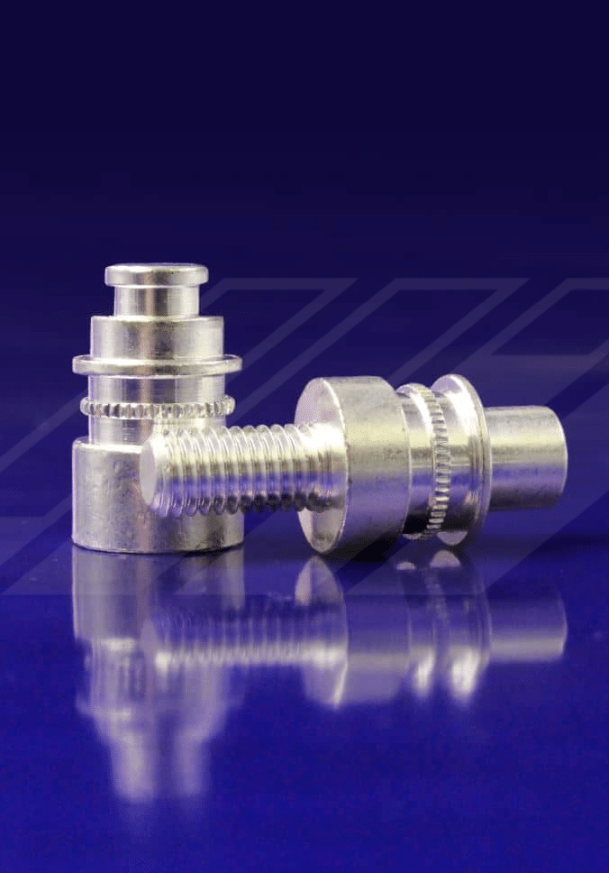

Figure 2. Silver-plated terminal contacts for EV power applications. (Image: Advanced Plating Tech)
Silver offers the highest electrical conductivity (6.3 × 10⁷ S/m) among noble metals. As shown in Figure 2, it is widely used in connector plating for high-power applications, including electric vehicle (EV) charging systems, industrial power distribution, renewable energy inverters, and aerospace power systems.
Although silver excels in threaded and sliding contacts, it tarnishes in humid environments due to sulfide formation, which increases contact resistance. Silver-palladium composites mitigate tarnishing while preserving 85% of silver’s conductivity, ensuring signal integrity and durability in high-frequency applications like 5G RF connectors.

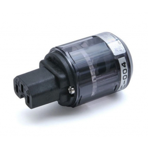

As shown in Figure 3, manufacturers use palladium as a more cost-effective alternative to gold in connector plating across applications ranging from audio-video, automotive, and telecommunications to aerospace and defense and Industry 4.0.
Connector plating
Figure 3. Oyaide C-004 IEC connector with palladium and platinum plating reduces signal loss and distortion in high-performance audio applications. (Image: Oyaide)
