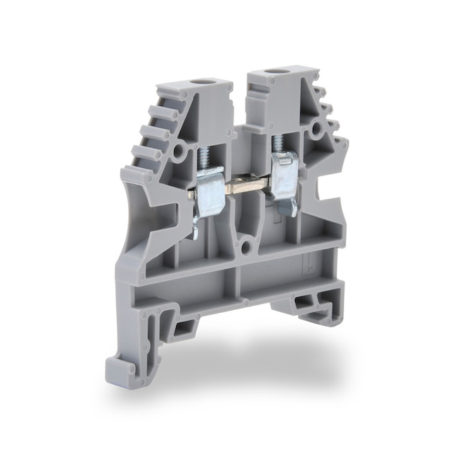

This single level terminal block from AutomationDirect shows clearly the basic mechanism of the screw-type block. Wires are inserted on the side and make contact with a conducting bar and are secured in place with a screw tightened from the top.
Another common way to classify terminal blocks is by the method of terminating the wire or making the connection. Terminal blocks are available with a number of different connection methods. The most common are screw-in types where the wire is pressed against a metallic conducting plate or bar and tightened down with a screw to secure it physically and make an electrical connection. Spring-loaded terminals use the force of a spring to maintain the connection of the wire to a conducting plate. There are also push-in terminal blocks where a wire attached to a ferrule is inserted into a hole in the block. Other types include insulation-displacement connectors (IDC) that don’t require the wire to be stripped prior to insertion into the terminal block.
