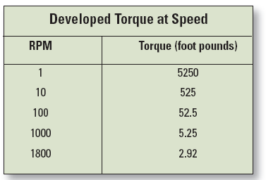

1 hp = Torque (ft-lb) X speed (rpm)/5250
Electric motors can be compared to one another in terms of horsepower only when they run at the same speed. In both motors and engines, horsepower is a speed-dependent unit of measure of work. It is possible to manipulate the required motor size for a given task by increasing the speed. Often, within certain limits, simply selecting a motor with a higher speed increases the horsepower rating. This lets a smaller motor at higher rated speed accomplish the same amount of work as a larger motor at a lower speed. Most constant-speed motors are designed to operate at 1800 rpm, so this provides a baseline to compare ac motors and variable speed drives in terms of horsepower ratings. When discussing the hp rating of equipment, ensure that everyone agrees that 1800 rpm is their reference speed.
