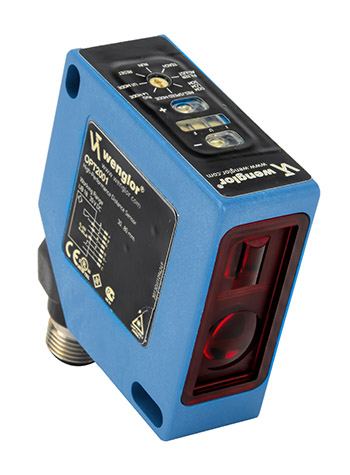

For high precision non-contact sensing, laser light sensors provide the best possible performance. These devices can be mounted some distance away from the sensed part, avoiding contact with the part and also the environmental conditions. The major characteristics for any laser sensor are sensing range, resolution, and cost. Not all laser sensors are equal, and many of their specifications including repeatable accuracy can vary substantially from one model and style to another.
Some styles of laser sensors just monitor the amount of light reflection, while other more advanced versions use triangulation or time-of-flight calculations for determining position. Regardless of the technology, performance is often quantified in the cost.
Basic laser sensors that cost about $300 provide 1-mm resolution with a detection range of 0 m to 3 m. For double that price, a sensor can deliver resolution better than 0.05 mm, although at a reduced range of 50 mm to 350 mm. For the same cost of $600, a sensor can offer an even better resolution of 0.008 mm, as long as a reduced range of 30 mm to 80 mm is acceptable.
This is not the end of the line for laser sensor performance. For thousands of dollars, a laser sensor can have a resolution of 0.00122 mm throughout a range of 200 mm to 1000 mm, or even 0.00006 mm with a small sensing window of 20 mm to 24mm. In addition to the cost, these more advanced units require special programming and communication interfaces to fully capture the available data. However, for the most demanding applications, the technology is available.
