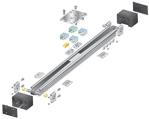

belt-drive-linear-actuators
Belt-drive linear actuators easily handle high duty cycles as there is no concern about frictional heat buildup in the nut.

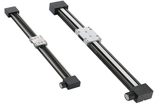

belt-drive-linear-actuator-system
Belt-driven linear actuators systems can deliver quick positioning of loads. Actuators are available for loads ranging to 450 lb (2000 N).
The DryLin ZLW systems are based on hard-anodized aluminum guide rail profiles, which offer a good mating surface for the linear bearing liners. Several linear bearing housings are available including low-cost zinc-castings, lightweight and corrosion-resistant hard-anodized aluminum machined parts, as well as adjustable versions which allow the flexibility to eliminate or increase the linear bearing clearance per the application requirements.
