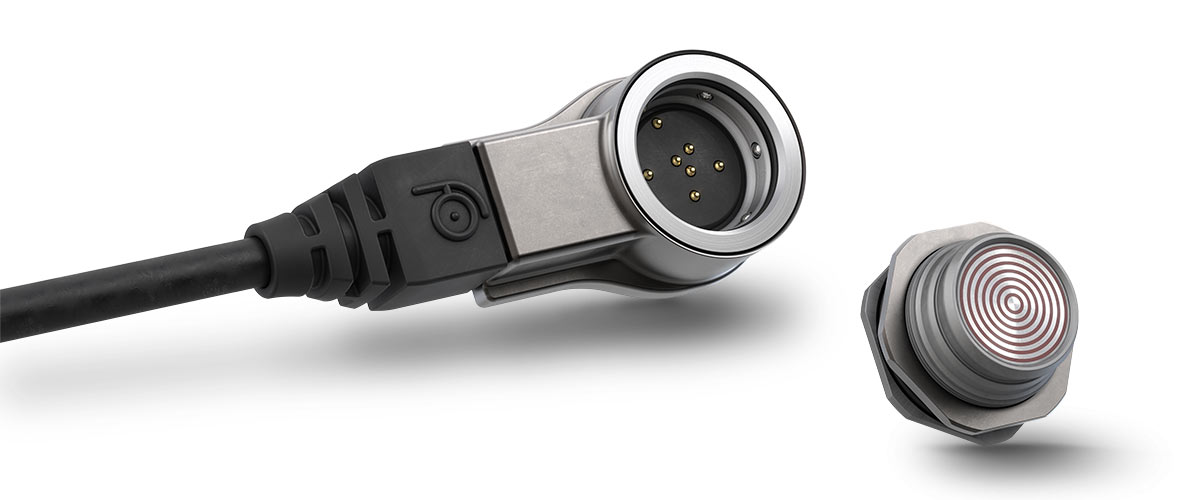

Circular connectors are available that have been designed to be sewn into clothing for medical monitoring devices. They feature 360-degree mating freedom of movement and are IP68 rated, simplifying cleaning (Figure 3). The low profile design is rated for up to 10,000 mating cycles. The plastic version is IP67 rated, rated for up to 5,000 mating cycles, and is 70% lighter than the metal version.
Figure 3: Some circular connectors have been designed to be sewn into clothing for medical wearable devices. (Image: Fischer Connectors)
