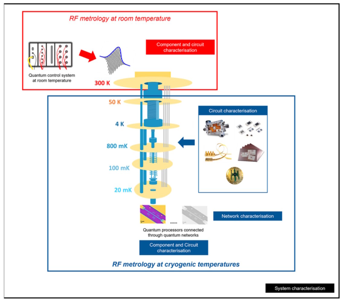

Many quantum processors operate at temperatures in the milli-Kelvin (mK) range. Those computers use µw pulses to state and operate the qubits. A quantum computing system has temperature regimes from room temperature down to mK.
The performance of the µw components, including amplifiers, filters, and mixers, used within the quantum processor must be characterized at their operating temperature, with the measurements linked to external systems operating at room temperature (Figure 1). Key measurements include scattering (S) parameters, power consumption, and noise.
Cryogenic
Figure 1. Cryo µw power metrology for quantum computing (block box) combines µw metrology at room temperature (red box) and µw metrology in the cryo sections (blue box). (Image: Cambridge University)

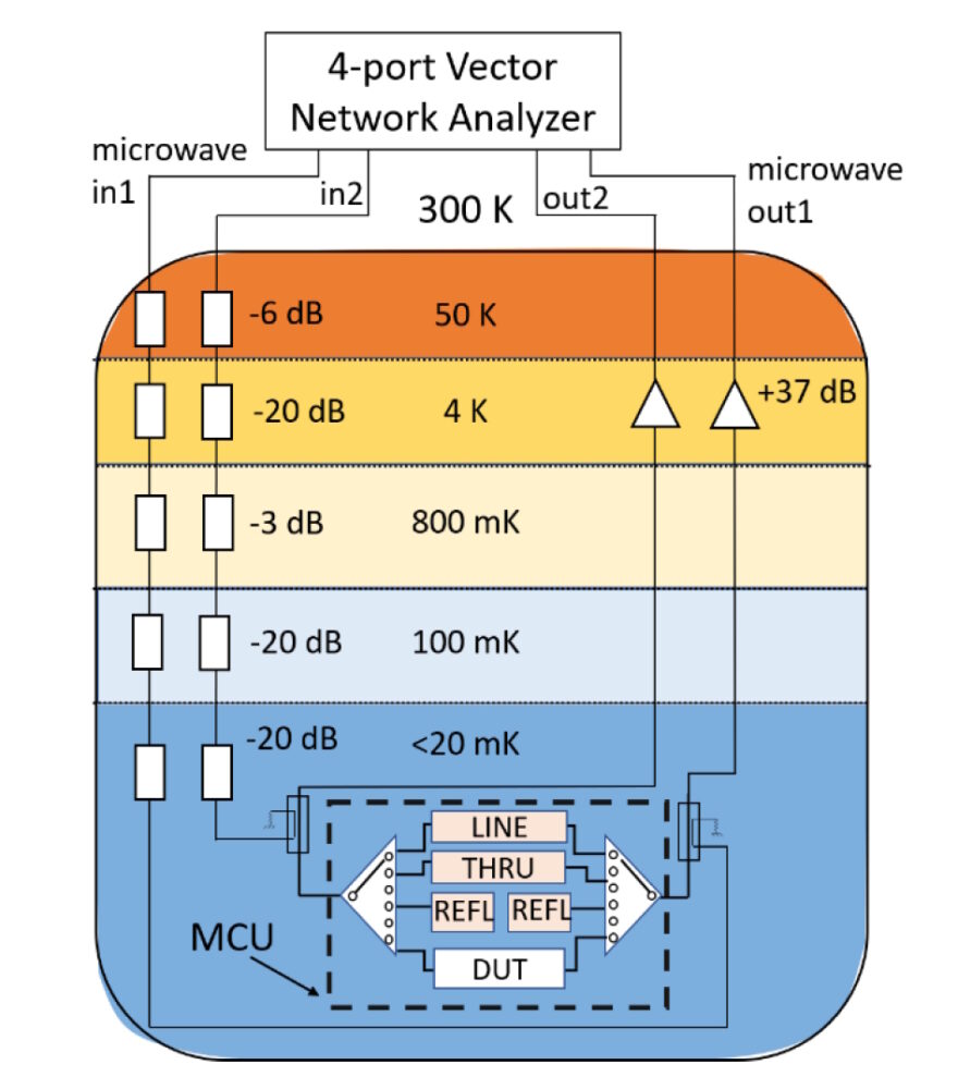

Cryo S-parameter MCU
One architecture for characterizing the performance of the cryo system is shown in Figure 2. The dilution fridge has six stages, dropping the temperature from room temperature (about 300 K) to under 20 mK. A vector network analyzer sits at the top of the system at room temperature, and the MCU is situated in the <20 mK section with the device under test (DUT).
Cryogenic
Figure 2. Cryo µw S-parameter test architecture. (Image: IEEE Access)
The interconnects must support high performance for µw frequencies up to several GHz and provide high thermal attenuation. The number of thermal photons reaching the coldest section must be well below the single photon level to ensure reliable qubit operation.

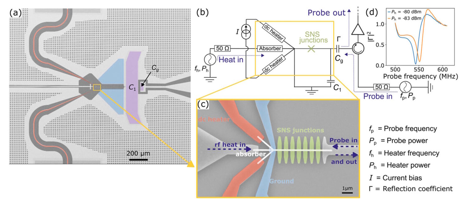

Cryo µw bolometer
A cryo µw bolometer has been fabricated to quantify the performance of quantum computer components. The design, shown in Figure 3, has three elements: a DC heater, a thermal absorber, and a readout circuit.
Figure 3. Cryo µw bolometer where (a) is a false-color image of the overall structure, (b) is the circuit diagram, and (c) is a false-color scanning-electron-microscope image of the detector. (Image: AIP Publishing)
