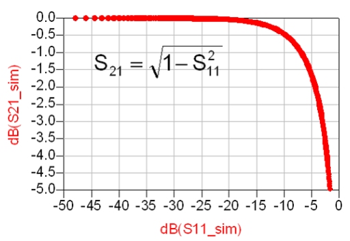

When an interconnect’s attenuation is low, there is a connection between the incident signal, the reflected signal, and the signal that reaches the transmitter. Most engineers think it is S11 + SS21 = 1. But remember, each S-parameter is about a voltage. There is no such thing as conservation of voltage. There is only conservation of energy.
The energy in each S-parameter is related to the square of the S-parameter, so the connection is S11² + S21² = 1, or:
Now we can explore how much return loss will begin to affect insertion loss, the signal at the transmitter. We usually measure S11 and SS21 in decibels. Thus, we need to convert the decibel value into a magnitude, do the calculation, then convert the SS21 magnitude value back into decibels.
The graph in Figure 1 shows the connection between how much S11 (dB), will affect S21 (dB). It’s startling that you can have as much as -10 dB of S11 before you see even a 0.5 dB drop in S21. That explains why a typical spec on S11 can be less than about -13 dB. A larger value would begin to affect the transmitted signal. Keeping the return loss below -13 dB means the transmitted signal will not be affected by reflected signals.
