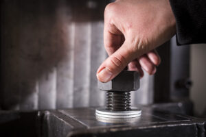

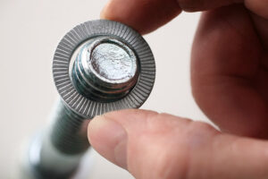

To prevent spontaneous bolt loosening, the slip between the joined parts needs to be eliminated or at least reduced to below critical levels. This can be achieved by increasing the axial tension or the friction between the clamped parts or decreasing the cyclic loading (for example, shock, vibration, or cyclic thermal loading).
Washers are often an overlooked component in securing bolted joints. Certain types of washers use tension — rather than friction — to prevent unintended bolt loosening.
Another common method is to increase the friction between the bolt threads. Although there are several effective ways to do this, some have disadvantages worth considering.
For example, glue or adhesives can be an effective friction-based method, but dried glue can be problematic when dissembling and removing the bolt. Furthermore, increasing the friction between threads would decrease the achievable preload at a specific torque level. Locking wire is a common method in the aviation industry.

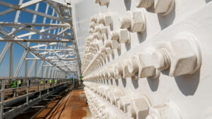

The key to avoiding fatigue is good design, which has grown in importance in recent years because of the increased demands on many bolted joints and increased use of lightweight materials. It’s important to avoid solely focusing on the tensile capacity of bolts while overlooking other parameters — such as elasticity and stiffness, which can also be important.
“Correct joint design is the key to achieving a high strength friction grip connection with a high preload level, and thus a high slip resistance over the entire lifetime,” says Dinger. “Up until now the focus for design engineers has been on the failure with bolts breaking. Other failure mechanisms have become more and more important as performance is increased and the weight of joints is decreased. The mechanisms of preload relaxation and self-loosening are more and more common in lightweight designs.”
Understanding why bolts loosen in certain applications is the first step to proper installation.
Depending on the bolt, the application, and the cause of preload loss, there are generally multiple options for designing more optimal bolted joints.
“In cases where there’s thermal loading, the joint can be optimized by choosing materials with equal thermal expansion coefficient for the clamped parts,” says Dinger. “To help minimize settlement and maintain a high preload during operation, you can reduce the roughness between contact surfaces. Measures such as fine hole diameters or toothed surfaces can help minimize relative displacement.”
Overall, achieving the optimal bolted joint involves factoring in multiple variables and design options.
“In general, a good bolted joint is made up of very elastic bolts and very stiff clamp parts, and there are different ways of achieving this. One way of improving bolt elastically is to have long clamp length. But if you have a flange, where the clamp length can’t be too long, you can change the design by using more but smaller bolts. So instead of using five bolts, you can use ten smaller bolts, which will create a more elastic joint,” says Seow.
