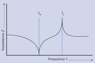

In an electrical circuit representing the piezo element, the frequency at which the impedance of the circuit is at a minimum is the series resonant frequency, fs. Conversely, the parallel resonant frequency, fp, in the equivalent circuit occurs when impedance in the circuit is theoretically infinite (assuming mechanical losses are ignored). This is also known as the anti-resonant frequency, fa.
The series and parallel frequencies are suitable approximations of the minimum and maximum impedance frequencies – fm and fn, respectively – and therefore are used to determine the parameters of the piezoelectric motor or system. Maximum response of a piezo system occurs between fm and fn. Piezo systems with a higher resonant frequency will have a better phase and amplitude response, which means that the operating frequency can be higher.

John Lassiter says
There is an error in the above graph of impedance and frequency. fm is at the antiresonant frequency and fn is at the resonant frequency.
