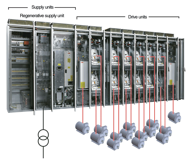

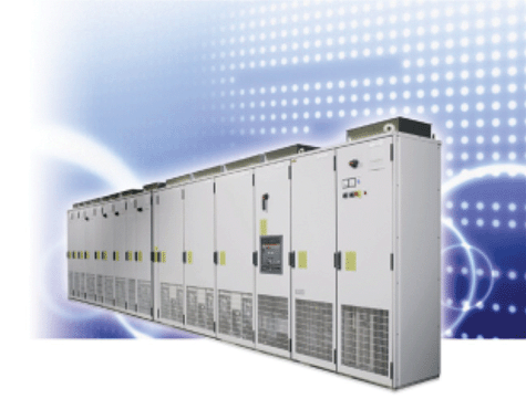

Multidrives, such as this one from ABB, are made from several components.
Multidrives
A multidrive is built from industrial drive modules that are connected to a common dc bus bar. This bus bar supplies the drive modules with dc power and each module then inverts the dc to ac and powers an individual motor. The dc power is derived from a single supply unit (rectifier) that is built into the front end of the same multidrive configuration.
This configuration simplifies the total installation and provides many benefits:
    • savings in cabling
    • reduced line currents and simpler braking arrangements
    • energy distribution over the common dc bus bar, which can be used for motor-to-motor braking without the need for a braking chopper or a regenerative supply unit
    • reduced component counts
    • increased reliability
    • space savings
    • the elimination of a separate Motor Control Center (MCC).
A
multidrive is built from industrial drive modules connected to a common
dc bus bar that supplies the drive modules with dc power. Each module

Overview of the construction
An ABB multidrive is built from several sections. The key units within these systems include:
The inverters have built-in capacitors for smoothing the voltage of dc bus bars.
Diode Supply Units (DSU) automatically adapt to 6- or 12-pulse operation. During start-up, they deploy a built-in control system that automatically charges the inverters’ capacitor banks.
IGBT Supply Units (ISU) used in regenerative drive systems and applications requiring low harmonics convert three-phase ac voltage to dc voltage.
Thyristor Supply Units (TSU) in a regenerative drive can regenerate power back to the mains.
In resistor braking, whenever the dc bus voltage of a frequency converter exceeds a certain limit, a braking chopper connects the circuit to a braking resistor.
Optional control units are equipped with communication interfaces, power supplies, and other devices for automation equipment.
