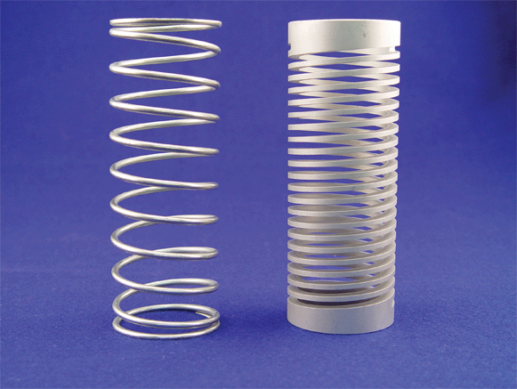

Wire springs appeared early in the Industrial Revolution and established their value immediately. The basic concept has not changed much, though there have been enhancements in materials and manufacturing. Typically, spring wire is coiled hot or cold with ends configured within the limits of coil wire, creating an industrial tool that exhibits elasticity.

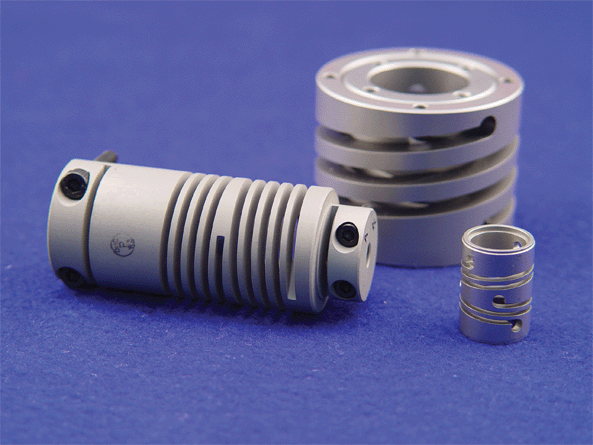

Machined springs function similarly to wire wound springs, but they are manufactured in a different way. Although any machinable material including plastics can be used, bar stock metal is the most common starting point for machined springs. The bar stock is first machined into a thick wall tube form. Then a helical slot is cut revealing multiple coils that when deflected, provide the desired elasticity.
The cost to manufacture machined springs exceeds that of winding wire springs. Wire wound springs can be created with just a few seconds of process time while a machined spring requires a minimum of several minutes. Plus, the machines used to create both forms are highly specialized.
Machined springs and wire springs function in similar ways, however, differences in manufacture affect their cost and suitability to various applications.

The coils found on wire wound springs are typically round. Sometimes they come in rectangular or rectangular with rounded OD and ID surfaces. These two latter forms are less common due to cost, however, they offer higher stiffness and are more compact than the typical form. The rectangular coils are normally used so that the long leg is radial, but the long leg can also be made longitudinal.
Rectangular wire comes in set sizes. You can venture from those sizes, but at an increased cost and lead time.

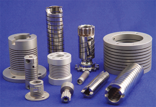

Coils used on machined springs are square, rectangular (radial or longitudinal), and trapezoidal. Trapezoidal coils are common to springs used in lateral bending and lateral translation. The shape allows for the additional lateral motion without coil contact. The size of the coil is easily changed to fit the spring’s needs. No standard sizes apply.
Slots. On wire wound springs the space between the coils (slots) is uniform for torsional springs and compression springs, but with compression springs the end slots tend to taper to zero. This process is called “closing” the ends, and is created by an additional forming process. Optional grinding makes the ends nearly flat.
Extension springs can have a uniform width from zero to most any size. If desired, the coils can be pre-stressed so that this spring shows a zero slot, however, you may need to exert additional force to overcome the coil separation threshold.
Currently, machined springs come with a minimum slot of about 0.020 in. (0.51 mm). Wider slots that do not exceed 0.250 in. (6.35 mm) are possible. The slot width can be closed to near zero using a stress relieving process, but no pre-stressing is currently available.

In a wire spring, the entire length of the wire contributes to the elasticity because the forces and moments are distributed end to end with the ends providing the interface with adjoining equipment.

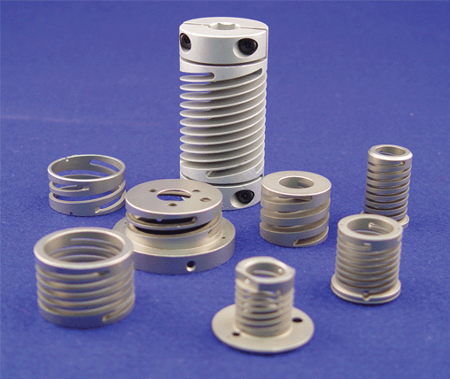

Machined springs are different. The flexure—the section providing the desired elasticity—is captive between the end sections, which provides structure and attachment. The end sections have infinite stiffness when compared to the flexure. Furthermore, the slots do not taper to zero at the ends; they remain at the full or initial width, as seen at free length. Thus, to achieve the same elastic performance, machined springs likely need to be longer than wire ones.

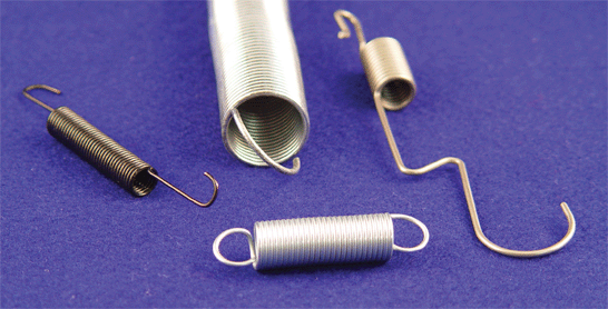

Most springs have many types of end attachments. Hook and loop attachments are common for wire springs.

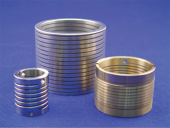

Machined springs’ coil slots are often too small to pass shot. Hence, shot peening is not common. Fatigue resistance often comes from stress relief holes and slots added to the slot ends. You can also select high strength, fatigue-resistant materials.
Wire springs can be plated with zinc and nickel for corrosion protection. Plating machined springs is uncommon because of the sharp edge corners, which typically receive insufficient coverage. The use of CRES and titanium materials provides excellent corrosion protection for most machined spring applications. Aluminum machined springs are typically anodized or coated to prevent corrosion.
Machine spring sizes are limited by machining practicality. The smallest springs are about 0.100 in. (2.54 mm) in diameter, and the largest are 6.0 in. (152 mm). Maximum length is about 24 in. (610 mm), but this applies to 1.0 in. (25.4 mm) to 3.0 in. (76 mm) diameter springs. Smaller or larger diameter springs will need to be shorter.

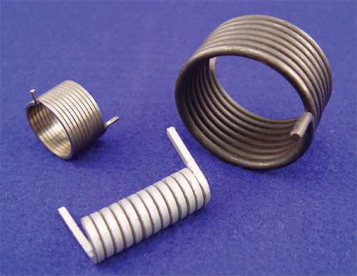

Wire wound torsional springs can have a rugged tang similar to that found in wire springs. Tang usage provides a moment force on a torsion spring.

Wire wound spring attachments include compression springs, clipped end or natural, closed, and closed and ground. Closed and ground attachments are a little more expensive, but they provide the most perpendicular surface to the spring centerline.
While wire springs are limited to the use of wire form attachments, creativity has provided many, cost effective versions. Machined springs can possess any feature that can be machined.
Compression springs are fully machined. The ends can be flat and very perpendicular to the longitudinal axis of the spring. Extension springs can have machined studs, threaded holes, and flanges.
Torsion springs can have a rugged tang similar to that found in wire spring. Tang usage provides a moment on a torsion spring. To accomplish this, a force at a distance is employed. The spring provides the moment action, but needs additional reaction to the force. Typically, torsion springs using a tang rub on a guide on either the OD or ID to resolve this force.
In a machined torsion spring, a pure couple can provide the moment. A pure couple can come from double tangs (external, internal and longitudinal), slots, splines (internal and external) and bolt circle configurations. One can also resolve the moment by an integral torque restraint on the coil side.
Machined springs handle single and multiple starts. Multiple start springs allow for a pure force reaction.
Machined springs have their own attachments.

Machined springs used in torsion
Typically, torsional machined springs are a little longer than equivalent wire ones. These springs benefit from attachments, however, they differ from wire torsion springs in that the coil ID can be reduced to add stiffness to the torsional rate. Adding stiffness to wire torsional springs requires a change in the basic configuration, such as OD, ID, wire size, or number of coils, or a change in the wire shape. Wire is available in rectangular and trapezoidal sections. Trapezoidal sections are generally selected for smaller ID springs so that post wound sections will approach being rectangular.
If you want to double the stiffness of a torsional machined spring, double the coil thickness or employ a double start configuration using the original coil thickness for both starts. A double start spring would provide more stiffness, but it would also be more expensive, longer and possibly experience static instability (buckling).
Buckling is important in torsion springs and becomes an issue when the number of coils increases and the coil width decreases. Both wind-up and unwind directions should be analyzed for buckling.
