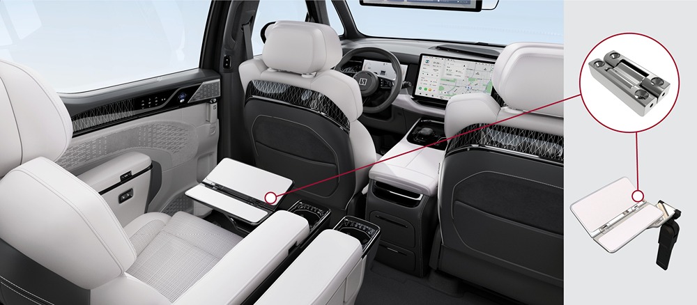

ZEEKR 009, the company’s first multi-purpose vehicle (MPV) EV, launched in 2022. It redefines the MPV, combining elegant design with a roomy and comfortable space. ZEEKR sought an integrated foldable table solution for this interior.
With the help of Southco, ZEEKR 009 makes the travel experience more convenient for passengers. Its flip-out table is designed to be lightweight, durable, and compact enough to conceal it in the armrest without taking up additional space. Southco engineered a customized solution specifically designed for ZEEKR. It not only meets the rigorous demands of the automotive industry but serves as an exquisite ornament that perfectly aligns with ZEEKR’s expectations.

Southco engineered a custom solution by seamlessly embedding the classic AH bifold positioning hinge in the flip-out table. This solution not only withstands the rigorous demands of the automotive environment, but also meets ZEEKR’s high quality and aesthetic standards.

No manufacturer in Asia had ever attempted such a feat, especially one employing friction technology for all rotating pivots and the attachment of leather to an aluminum alloy surface using glue. Additionally, it had to offer smooth 180° operation while maintaining low noise. These stringent requirements also included mirror polishing and chrome plating finish options, and a balance of high rigidity and low weight in a constrained space.

In response to this formidable challenge, Southco delivered a fully customized solution that meticulously catered to ZEEKR’s specific requirements. Supplier in Asia lack the necessary expertise to design and manufacture flip-out tables, so this is Southco’s first attempt at creating such a product. Driven by passion for perfection, Southco collaborated with a professional leather supplier to explore various finishes, seeking the perfect touch to adorn the magnificent ZEEKR 009. As a result, the table developed by Southco achieves a sleek and sophisticated look that aligned perfectly with the ZEEKR 009’s luxury image.
Southco engineers confirmed the optimal operating force and the resistance to vibration by applying the friction technology from Southco AV and AH hinging solutions. The hinging solution features constant torque, which allows for controlled resistance through the entire range of motion. Additionally, the flip-out table is designed with Southco positioning technology. Passengers are able to silently operate the table with ease, and hold it securely in any position even under vibration or dynamic loads, facilitating smooth 180° operation without requiring any adjustments.
Occupying minimal space, this hinging solution allows flip-out tables to deploy to a secure horizontal position, and then easily fold and stow flat when not in use. Say goodbye to bulky and cumbersome table mechanisms – Southco delivered a streamlined solution that maximizes both functionality and space efficiency.
