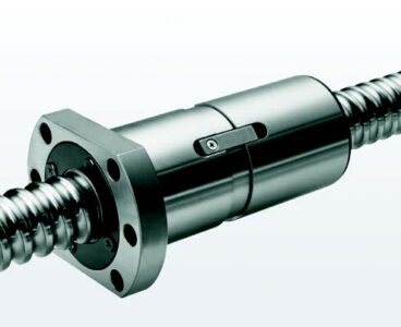

Compact Ball Screw SDAN-V
The Model SDAN-V is a compact precision ball screw with an external nut. New technology is utilized inside the ball screw nut to achieve an ideal ball circulation structure with smoother rotational motion. The double nut system provides for high rigidity. THK offers 7 screw shaft diameters from 32 to 63 and lead sizes 5 mm to 40 mm for 47 possible combinations.

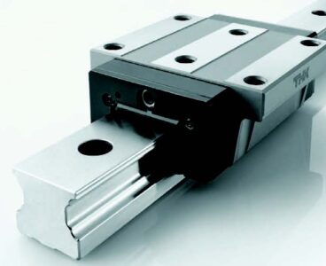

Type HDR LM Guide
Our new Type HDR LM Guide offers a rigid design that is suitable for single rail applications. It enables single-axis tables to be compact and lightweight. The ball raceways of the Type HDR are positioned on the sides of the LM rail, making it difficult for foreign materials to reach them.
This LM Guide is ideal for applications where a constant MC moment will be applied. The HDR offers an improved dust-proofing plate cover easily be applied to rails up to over 5 m long.

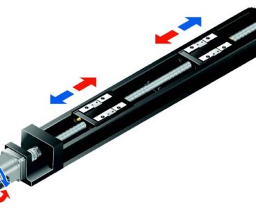

Two drive systems are combined into a single package for a compact overall design. The Type KR-RL handles loads in all four directions (radial, reverse-radial, and horizontal), making it possible to install in any mounting orientation. It is optimal for end effectors of robot arms that move freely.
