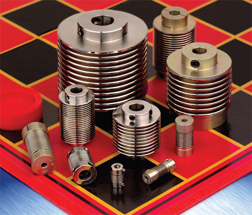

Design engineers with precision rotary motion requirements have a range of flexible couplings from which to choose. For instrumentation and fractional horsepower applications, electrodeposited nickel bellows are a premium but often overlooked solution for applications with positive displacement, zero windup, and low or minimal backlash.
Compact bellows couplings accommodate more than 30 times the angular misalignment and 15 times the compression or extension tolerated by common Oldham couplings. In some precision motion assemblies, the flexible bellows couplings pay for themselves by eliminating expensive alignment steps. Thin wall bellows are light, flexible couplings that improve the performance of fractional horsepower drives and minimize the side thrust of misaligned shafts. Metal bellows also withstand extreme temperatures and harsh chemicals better than elastomeric couplings.

Bellows-type couplings tolerate deliberate motion or assembly misalignment. They remain torsionally rigid, yet axially, laterally and angularly flexible. The design, material, and fabrication process of electrodeposited nickel bellows couplings provides flexibility and torsional rigidity. Their convoluted bellows form transmits rotation without windup as they bend, compress, and extend. Actual performance is determined by bellows wall thickness, inside diameter, outside diameter, length, and the number of convolutions.
The electrodepositing process builds nickel bellows of precise thickness and diameter on a custom-machined aluminum mandrel. Subsequently, dissolving the mandrel leaves a convoluted tube as small as 0.89 mm in diameter with walls down to just 0.008 mm thick and weighing very little. The sharp radii of the electrodeposited bellows segments can also be made just three times the wall thickness, far smaller than radii produced by mechanical forming. Thinner walls with less mass reduce coupling inertia and power losses when drives start and stop. Sharper convolutions and more ductile metal also make electrodeposited nickel bellows more flexible to minimize side forces between misaligned shafts. Low side forces protect bearings and other components from wear.
Bonded to aluminum hubs or soft-soldered to stainless steel hubs, an electrodeposited nickel bellows coupling exhibits about one quarter the windup of hydroformed bronze or stainless steel bellows. Elastic windup is typically less than 1 arc-second per N-cm.

In a flexible metal bellows coupling, the bellows element flexes axially but not torsionally for zero backlash and very low windup. Compared with thick-walled hydroformed stainless steel or bronze couplings, low-mass electrodeposited nickel bellows with aluminum hubs create a far smaller moment of inertia that preserves the performance of low horsepower drives. Versus machined beam couplings, lighter electrodeposited bellows couplings simply require less power to start and stop. Servometer typically holds concentricity of electrodeposited bellows within 12.7 mm. Cyclic speed variation through 360° rotation is consequently non-existent.
