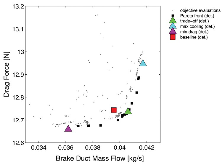

Consider, as an example, the optimization of a brake-cooling duct for an F1 car. John Axerio-Cilies, a PhD candidate at Stanford, along with his co-authors, recently looked at this problem.* His overarching goal was to improve the brake duct design in the presence of uncertainty, and determine the trade-off between maximizing brake cooling, and minimizing drag.

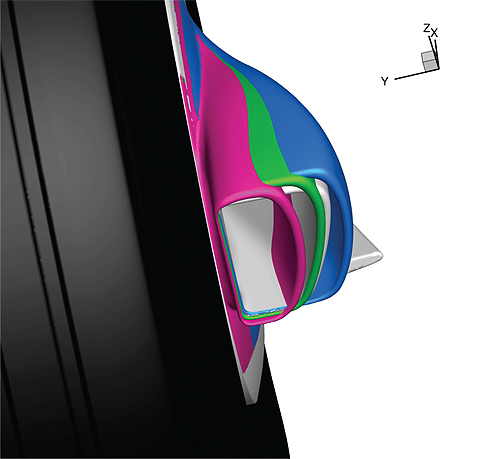

Axerio-Cilies found that, of all the areas of uncertainty considered, tire yaw angle, turbulence intensity, and contact patch width were the most significant. He found configurations of the brake duct that provided either maximum cooling or minimum drag, as well as a configuration that provided a good trade-off between these, and slightly better performance than the baseline design.

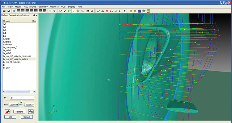

The key to reducing the solution time to an acceptable number is to not redo things that don’t need to be redone. Rather than modifying the CAD model and re-meshing, Axerio-Cilies used Sculptor, a mesh-morphing tool from Optimal Solutions.
Sculptor started with the baseline mesh, and, using Latin hypercube sampling (a statistical method), created a large number of variant meshes, in just a few minutes. In each of these variant meshes, only a relatively small number of cells were morphed. Most of the cells were unchanged. The result was a massive reduction in analysis time—from 1 day, down to about 2 hours per run. Using cloud computing, Axerio-Cilies was able to run thousands of analyses in only a few weeks total time.
