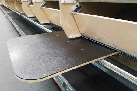

In this recent application, an automated package distribution center was looking to improve its packaging modules. Each module is made up of four chutes that feed packages from the top of the system down to the station operator. The operator is notified of an order and, from there, can pull it out, package it and place it onto a conveyor belt beneath the chutes. The customer wanted to incorporate support platforms onto the design of this existing structure, which the operators could use to box the finished orders.
A few solutions were initially proposed, including a scissor lift, a drop shelf and a motorized, wheeled cart. However, all of these systems would operate apart from the existing module without having to mechanically interface with it. These ideas were ultimately scrapped because they were too costly or had ergonomic problems associated with them, requiring workers, for example, to twist, running the risk of injury.
N-III ended up solving these issues with a simple design that connects to the module and even uses its existing boltholes. For a work surface, the engineers created tables made of strong ply, which they capped with an ABS plastic. These ABS “tops” were water jet cut and served as the template to rout the tables from the ply. The tables were then mounted onto a linear slider, which was mounted simply into a standard aluminum extrusion.
From there, workers can slide a table along the length of the chutes to where it is needed—a taping station, for example. While there is one table per four modules, tables can travel freely across up to 12 modules, maximizing design flexibility and minimizing the number of tables that need to be installed.

The success of N-III’s solution is owed, in part, to engineers’ flexibility over the course of the design process. For example, it became apparent that the use of a 1 x 1 inch lateral bar would not be able to accommodate the moment loads created by the weight of the packages on the tabletops. A 100 lb package placed at the end of a table would create a 600 lb load on the supporting structure, pulling the bearing out of the rear track. To ensure that the system could hold up to these loads, engineers first ran a finite element analysis (FEA) test to analyze and compare system stress under loads using a 1 x 1 in. and 1 x 2 in. lateral bar. Whereas the 1 x 1 in. bar deflected, engineers discovered that the 1 x 2 in. bar could handle the high loads of the heavy packages. They therefore integrated this new component into their design.

N-III’s solution overcame several design constraints, all of which were dictated by the existing packaging structure. For one, engineers had to figure out a way to attach the tables to the structure without any additional drilling or the use of T-nuts. Besides being more expensive than the aluminum sliders themselves, logistically, incorporating T-nuts would have been a design nightmare. Instead, the engineers designed pre-drilled and tapped bars that, once inserted into the extrusions, readily aligned with the track’s 4,000 existing boltholes.
It was also important that the design maintain a certain height so as not to impede the conveyor belt beneath the staging module once it was attached. N-III’s solution added only four inches to the vertical space between the module and the conveyor underneath.
