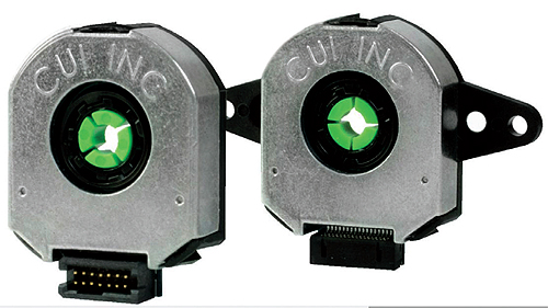

In contrast, capacitive rotary encoders used for commutation can be more accurate than Hall effect sensors, less expensive than optical encoders, and much more rugged than the opticals. The setup process of mating them to the motor and aligning is simplified by the use of a microcontroller and built-in ASIC that digitally sets the zero position, pole count and commutation angle.
To read shaft position, a capacitive transducer uses an encoder disk that modulates the capacitive coupling between electrodes on a transmitter disk and a receiver disk. Conductive segments on the rotating disk couple high-frequency (about 10 MHz) signals between the transmitter and receiver boards. The relative amplitude of signals coupled from different parts of the transmitter board depend on the position of the disk and so serve as a means of measuring the shaft position. An ASIC uses this amplitude information to compute the sensor position for each measurement cycle. Additional computations on the ASIC create a continuous model of the rotational motion and derive quadrature signals similar to those from optical encoders.
Specifically, a synchronous detector and low-pass filter at the receiver strips away the 10-MHz carrier and leaves the amplitude modulation, resulting in a signal that is effectively sinusoidal at about 10 kHz. Its phase is a measure of the angular position of the encoder disk. Other circuitry on the receiver detects the zero crossings of this signal. The resulting information is used to note the count at the time of the zero crossing. The count becomes a digital measure of the angular position of the encoder disk and thus generates the digital representation of the shaft position.
The specially designed ASIC chip can also adjust the quadrature resolution among 16 different values from 2,048 to 48 ppr.
A final point to note is that the capacitive encoder generates its commutation signals by parsing its 4,096 absolute positions to accommodate the number of pole pairs programmable by the user. This offers a broader flexibility in motor choice with higher switching accuracy not available with optical encoders.
